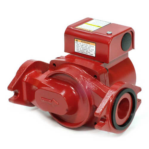

The "primary loop" is the boiler loop, in this case driven by the internal pump of the Navien, and it's flowing counter-clockwise. It's driving out the left-most port, so secondary loop flow (driven by the red pump) needs to be toward the tee branch node closest to the boiler's intake port, which it is (I think), and also flowing counter-clockwise. The pump looks like a Bell & Gossett, and with the pump motor on the top the arrow on the bottom of the housing would be pointed right, toward the bottom tee, not away(?). (You may have to get down on your knees to do the visual inspection on that.)
The fact that Navien's manifold has the tees pointed at the boiler, with the secondary loop going though the straighter, fatter pipe shouldn't much matter if the tees were space properly (which they aren't). It also doesn't really matter very much if the secondary pump is on the supply side or the return side, as long is the direction is correct.
So could it have been done better? Yes, no doubt!
But is it bad enough to be a real problem? Probably not.
If in some alternate left-handed spin universe the red pump is pumping away from the tee it's an easy fix. The flanges are symmetrical, and it can just be flipped around.
