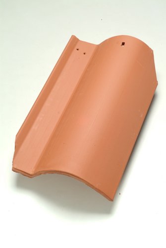

    Customer has leaky roof. Determined that it is from poor flashing job around chimney. Planks of wood roof are rotted. The whole roof is in this order:
    t&g planks, tar felt paper, rolled shingle roofing paper, Spanish tile.
    Now to the question, they want to know if the area in disrepair is fixed how does one make certain that when the clay roof tile is nailed down that the nail penetration doesn't in turn invite a leak.
    [​IMG]

    If you put down a layer of Bututhane (sp?), it would seal around the nailholes. This stuff is made by various companies - Grace being one. It comes on a roll, about 4' wide. It is sticky and is sort of like double-stick tape with a release layer. It is often called ice and water shield.

    The nails are under the next course of tiles so the rain should not flow over or around them. The same as with any other roof covering, i.e.; shingles, rool roofing, etc.

    Never heard of putting rolled roofing under tiles. Back in the day, the tiles were put on skip lath, but today they use plywood, then felt, then the tile. Nails are not an issue. With tile roof, it is ALL ABOUT the flashing. The guy has to know what he is doing to flash everything well.
    Make sure to install bird blocks and fire stops on the eave ends. Many homes with tile roofs were lost in the recent fires due to embers blowing up under the eave edge of the tile.

    The clay tiles don't seal like a typical 3-tab roofing, so rain can blow or ice dams can move water up under them much easier than they can with an asphalt roof. Ice and water shield will protect things. It may be overkill, and not necessary in all areas, but it will help if the conditions exist.
