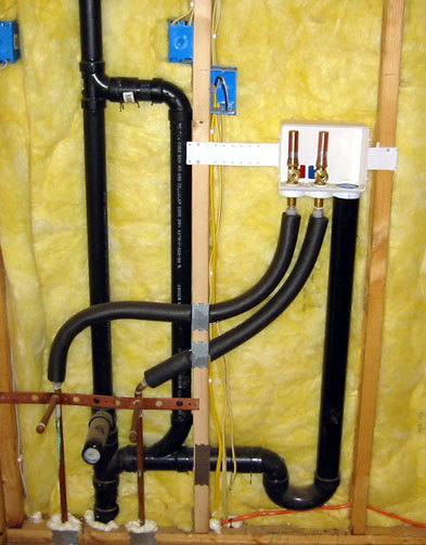

    Hello all,
    I'm replacing an old lead bathtub trap and adding a washing machine drain at the same time here. My concern is to make sure I'm doing the Y correctly to prevent washing machine water from backing up into the tub. Specifically, would it be better if the tub Y'd in from the top rather than from the side? The tub is the 1.5" trap, the washer is the 2" pipe facing the camera. The center of the horizontal pipes is 7" below the floor. I don't think it matters, but the washer drain has 3 elbows and a trap before entering the photographed area.
    Bonus question: The rubber hub donut is not very tight. Previous ones I've used had to be soaped up and driven in. This one just pressed in by hand. Should I put some kind of sealer on it?

    You need to get some vents in there. One for the tub, another for the washer. You may have already planned the vent for the washer (and we can't see it), but the way it is, the washer will likely pull the water out of the tub trap when it discharges.

    The vent is directly above the old cast iron pipe. I was of the impression that this was adequate to vent both items, but I do see what you're saying with the velocity of the washer possibly creating a suction. I could go from just to the right of the tub trap up the wall and tie into the existing vent. It won't be easy since it's galvanized steel up there, but it beats going through the roof. There is no vent for the washer out of view. I can't see the need for one being as there's one at the cast iron like I said, but maybe I'm missing something.

    Every trap needs a vent in order to protect the trap seal. Also, the CI pipe might not really be a vent. If there is something draining from an upper level, it is not considered a vent. Sure, it may have worked like one, but a plumbing inspector would not approve it as a vent now (if being used as a drain). Even if the CI was a true vent, it would be fine if only the tub was connected like that, but since the washer is also tied in, there needs to be a vent between the tub trap and where it connects to the washer drain. An inspector will want to see a vent for the washer as well. If the CI pipe is a true vent and within distance, it may work without another vent on the washer, but I think your distances are too great.
    For 2" pipe, you typically need the vent within 5' to 8' (depending on your code) from the trap. Another challenge with vents is they can't go horizontal until at least 6" above the flood rim of the highest fixture served (or sometimes 42", whichever is larger). This can make some of the underfloor connections tricky (tub, shower, etc.).
    BTW: Typically code calls for the washer trap to be above the floor (in a wall) and there are limitations (min and max) on how tall the washer standpipe can be.

    Hmm, very interesting stuff. The CI is a true vent, there is no upper level. It changes to a galvanized pipe and turns horizontal just above the toilet tank, then ties in to the 6" CI vent going out the roof. The washer hookup is just barely past the foot of the tub, so about 6ft away from the CI pipe. I'm interested in why the washer trap would need to be in a wall, as I've already planned to place it under the floor. There won't be an inspection, but obviously I want it to work well anyway.

    The washer trap is usually raised as there is a limit on how long the standpipe can be. Around here, it has to be between 18" and 42". If you put the trap below the floor, you will exceed the 42" mark.

    The washer needs to come in "below" the tub drain.
    Cut a fitting in below the tee, run over for the washer, extend through the floor and trap it at about 12" from the floor, vent it and either go through the roof at that point or revent in the ceiling to the existing vent that the tub uses.
    If you run the washer past the tub, is will suck the trap dry.

    The cast iron pipe WAS a vent at one time, but now that you have changed the piping it is useless as a vent, and could be eliminated if it were necessary. Falling water has "inertia" and if it falls far enough, its inertia can carry it right through the trap without stopping to keep the trap full of water.

    You can't combine the tub and the washer on the same line without two individual vents.
    The traps need be vented before they combine.
    If that means you go farther back, then that is what you do. More pipe will need to be worked on and replaced if you plan on "adding" more to the job.

    Unfortunately, we cannot really tell WHAT you are going to do based on your description. The washer trap should NOT be under the floor, for several reasons, and if it is NOT under the floor it DOES require a separate vent. The tub CANNOT connect to the washer drain unless it also has a vent. HOW you do the venting is the reason we have to go to school to become plumbers, and we do NOT have enough information, from the pictures, to advise you on it. As far as the donut is concerned, if it is NOT tight in the hub or around the pipe, it WILL leak. You probably have the wrong donut, but since it was lead piping the cast iron should be from the era when the hubs were NOT made to fit rubber donuts.
