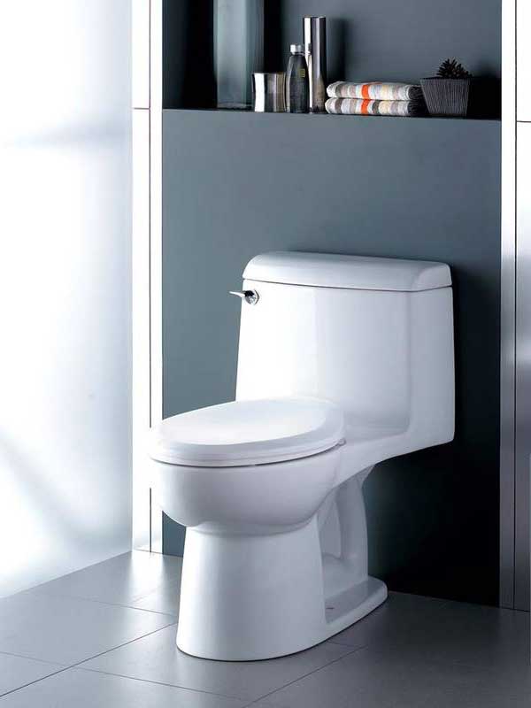

Champion One-Piece Model:
*The One-piece Champion 4 Flush Valve appears in photos to have its Flapper Valve Seal a little closer to the Tank Bottom as compared to the 2 piece.
Question 2: Is there a height difference between the Champion 1 piece and 2 piece Flapper valve seal??
*With the One-piece model, modifications would be limited to:
-Extending Height of Flush Valve Fill Tube.
-Changing out the Flapper Seal with a heavier rubber seal from Korky.
-Replacing the stock Water Fill Valve with a taller one if needed to match the taller Fill Tube.
-The One-piece costs around $525—more expensive

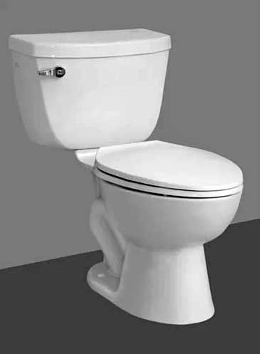

Champion Two-piece Model:
*The Two-piece Champion 4 Flush Valve Flapper Seal appears in photos to be even higher up from the Tank Bottom than the One-piece model.

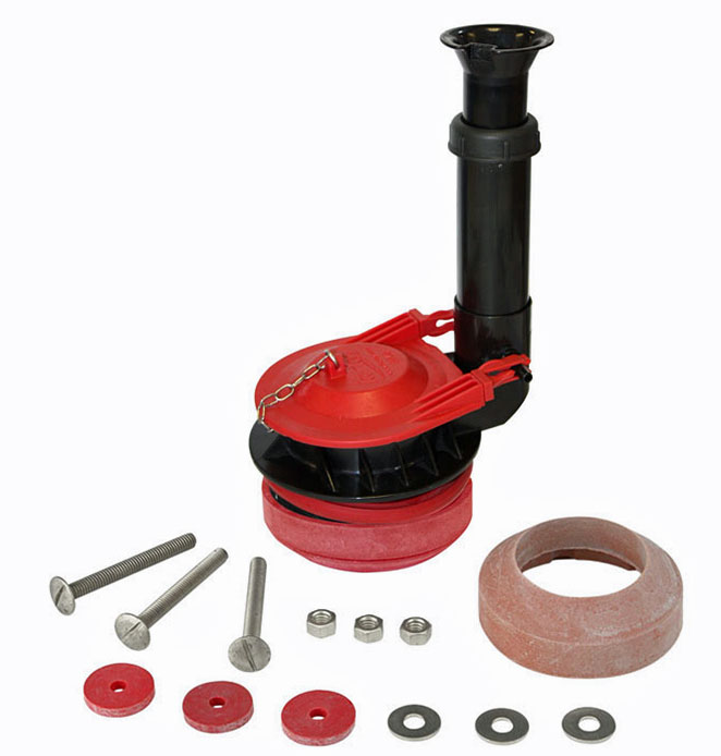

-The whole stock Flush Valve could be exchanged for a large 3 inch version from:
*Korky
*Nuflush.com (newer company)
-Both the Korky and Nuflush versions allow for extending or adjusting upward to Fill Tube height.
-Both use heavier rubber flapper seals to prevent ghost flushing.
-The Two-piece has a big price advantage of only $249
Question #3 Concerning Champion Two-piece:
-Since everyone concurs that the Champion 4 Flush Valve tapers into a 3 inch Tank Hole Outlet, my specific question is:
*Question 3a: Is the Champion Two-piece Tank Hole diameter the same as the other 3 inch Tank Holes from American Standard such as the Cadet 3 Tank Hole?
*Question 3b: Would a Cadet 3 (two-piece) Flush Valve fit a Champion 4 (two-piece)?

If you want to modify a Champion, then get the two-piece and install the Korky flush valve replacement that uses a flapper in the tank.
