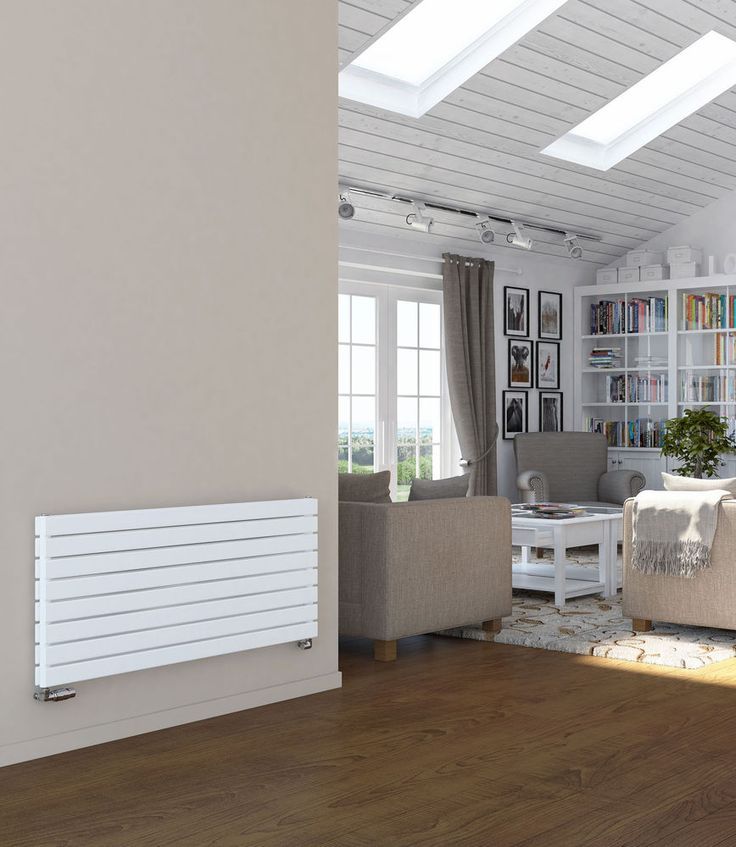

Unlike fin-tube convecting cast iron baseboard are RADIATORS, and you can FEEL the difference! Fin tube baseboard has very little radiant output, and are almost exclusively convectors, heating the air rather than radiating heat directly to the objects & occupants in a room.
But European style low-temp thin profile steel flat panel convecting radiators are real radiation too, cheaper, and at least as comfortable as cast iron baseboard rads.
buderus-logatrend-flachheizkoerper-ventil-kompakt-typ-11-hoehe-300-mm-breite-400-mm-leistung-222-watt-ventil-links--bud-7728208704_3.jpg
Bi-metal & aluminum convecting radiators popular in Asia and parts of Europe are faster reacting due to the lower thermal mass (lower water volume), but are also excellent radiation from a comfort and efficiency point of view:
To get the maximal comfort & efficiency out of radiation (cast iron baseboard or other) is to use an "outdoor reset" approach to the water temperature, so that the radiator is always at just the right temperature to keep the room at temperature and not cycling the temperature up /down by very much. With the water temperature tuned to respond to the outdoor temperature, the radiators are always radiating, rather than delivering a hot-flash followed by a chill.

Buying Burnham or Weil-McLain cast iron baseboard new it's tough to get the materials cost very much under ~$40/foot, Asian knockoffs maybe $30/ft. In my area there are scrap yards that will sell you a mile of used c.i. baseboard at $15-20/foot, sometimes less.
19'-20' of 9-10" cast iron is rated ~10,000 BTU/hr @ 180F AWT, for $750-$800 material cost.
A premium-brand flat panel rad with that much output runs ~$500-550.
A decent middle of the road Myson that delivers ~10KBU would be under $400, as would aluminum or bimetal convecting rads.
Flat panel radiators are definitely less expensive than new c.i. baseboard, and sometimes even competitive with used c.i.
Most of the thermal mass in a cast-iron baseboard is the ~2.5lbs of water per running foot, not the iron itself. Steel flat panel radiators typically have more thermal mass per rated BTU than cast iron baseboard, aluminium convecting rads usually less.
For guesstimating how much c.i. baseboard it takes to deliver a room's design heat load at 140F AWT assume ~300-325 BTU/hr per running foot. So a bedroom with a design heat load of say 2500 BTU/hr with 140F would need a minimum of 2500/300= ~8', which isn't too tough to manage, whereas a great room with tall windows and a design heat load of 11,000 BTU/hr would need 11,000/300= ~37', and may not have enough running exterior wall length to get there, but a flat-panel rad solution would fit. (A pair of ~20" tall x 7' wide Myson T621-5-20s can deliver that much, for under $700.)

The panel rads you listed above, are they simple series loop like fin-tube and CI BB or do they use monoflow/diverter Tees?

Euro-style panel rads tend to have their own tunable internal bypass branches and an adjustment knob on the side for tweaking the radiator flows (there are thermostatic valve/knobs too) and get plumbed in series, without monoflow tees. The number of panel rads that can be plumbed in series is sometimes limited though (three is a typical number, but consult the manufacturer's literature.)

The steel radiators are another option, but I'd have to get used to the look. To me they look more clunky although that's what most people say about cast iron baseboard. It seems to me that stretching out a cast iron baseboard along the outside wall gets you more radiation at every point in the room plus there's the small amount of convection directly under the windows unlike a steel slab radiator which is more like the old large cast iron radiators that are off to a side.

NY_Rob: At an AWT of 100F a panel radiator of any height puts out about between 1/5 and 1/4 of it's rating at 180F. So if you're just getting rid of the HE2 and replacing it to cover a 1500 BTU/hr load you're looking for something rated at least 4 x 1500BTU/hr = 6000BTU/hr @ 180F AWT, but doesn't need to be more than 5 x 1500 BTU/hr = 7500 BTU/hr @ 180F.
Something like a ~2' tall x ~40" wide Ecostyle B-24.40 would do it, or a ~3' tall x ~32" wide B-36.32 would more than cover it.
For less money a ~2' tall x ~48" Myson T6 IVC T621-6-12 or 2' tall x ~36" wide T622-6-92 would also do it.
