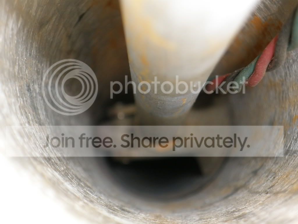

    I've got a leak or bad check valve and need to pull up my pump.I've never done this before but last time I had this same problem it cost nearly 2000.00.It was just a rusted nipple but I was told I should opt for a new pump,What a rip.Anyways I couldn't figure out the pitless connection but what I'm looking at online seems as if mine is of the "cable"or "spring" type.There is no cable on it but it has a piviting lever that contacts the side of the well.I pulled and pryed as hard as i could like an idiot until I noticed the lever.I tryed to make a hook out of some old copper tubing that was laying around but no luck.What should I do to unhook this thing? Am I on the right track??The well has been running all summer on 5 sec. off 15 sec. 24/7.I thought this was the case but only verified the problem after a 300.00+ electric bill.Thanks for any help you can offer

    I'd look at that last $2000 invoice and see if they made any special notations on it as to pulling the pump in the future. If this is what I think it is it's referred to as a spider pitless and can be a pain in the butt to remove. Normally there is a steel cable that you can pull up on to lift up the rear leg so the adapter can be pulled to the rear of the casing and then lifted up out of the well. If not I would see if there's a way you can make up a hooked device to pull up on this rear leg to be able to pull the pitless back and then out of the well. Let us know.

    This is most likely what you have down the well. A standard pitless puller will not work. You need to have both the cable that pulls the latch up and the cable that keeps the pipe from falling down into the well. If the latch cable is not there you will need to fabricate a hook. Also make sure there is another strong cable attached to the drop pipe. You may very well want to have a well company come out and do this as they will have the hook.

    The adapter I have looks similar to that drawing.The "actuator" lever doesnt appear to have ever had a cable on it. I've tried everything to get this dang lever to release but I'm not sure if it needs to go up or down.I made a hook and tried every thing I could think of with no luck.Any suggestions?

    [​IMG][​IMG] I don't know if these pictures will help but you can see what I have although blurry

    No help here, I've never seen anything like that before. Maybe you have to pick up the weight of the pipe/pump before it will 'unlatch'.

    I've used a prybar,tried turning it with a pipewrench,tapping with a hammer while prying.I've tried both lifting and pushing down on the lever but it doesn't move.I'm afraid I'll break it and really be screwed.I've searched the web to try to get a better idea of how its supposed to work but I havent found anything like this piece of crap.

    The lever pulls up. The bigger issue is what are you going to do once you have it out. You're going to either have to find the same pitless, hope the one you have survived, or dig up the casing and replace the old one.

    That makes sense, I looked down the inside of the pipe and thought it looked like some sort of screw.How far do I unscrew it and does it allow the lever to go up or down? Do I then need to pry the fitting apart or will it just seperate?Thanks so much for the info.Gary

    I just rapped it up.The last company to "fix" the well didn't install a brass nipple like they told me they did. The nipple rusted out just like it did a few years ago.I guess they didn't want to spend $8.00 on brass since they were only charging me 2000. Thanks for all the help especially to Anna she saved the day.Gary
