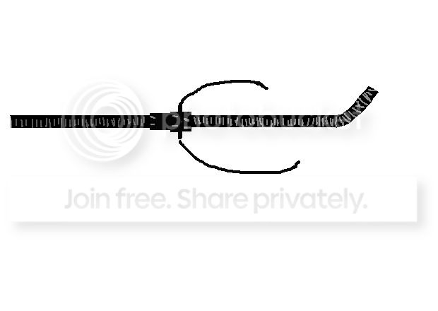

I obviously mean using the pipe after removing the toilet. But unless you have a snake with a very "wimpy" cable, it is not going to make the "S" turn into the bend and then down into the stack without some real work and luck. Most strong cables are going to try to make a "U" turn and go up the stack, unless there is a lot more distance than the common 12" between the two.
Have you ever actually tried to do this? Because you couldn't be more wrong. I can get a 1/2" steel cable down most toilet flanges....
The size of head you're using is really what determines how well it goes.
Like I said I have done this literally probably 400 times so I'm not just talking about my rear-end here. I have plenty of experience to speak from.
33,603
1,042
cable
I use a 1/2" cable for 2" sink drains, NOT a 3" or 4" main line. That is a job for a 3/4" inner core cable, which does not like to make a short "S" turn, but LOVES to cut difficult roots.
