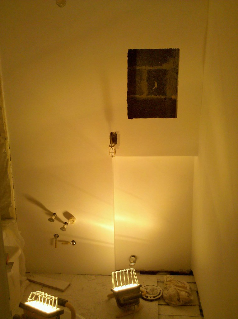

    No dice.... 10 5/8 it is, and not hair more. You might call me crazy, but I am going to possibly move the wall back (just behind the toilet) a little. I always hated it anyway, as it is somewhat crooked. The sad part is that I just skimcoated that section :( . I only need a half inch or so, and will see if the pipes behind the wall allow for that. Once again, any standard for minimum distance between tank and wall?

    Thanks for the replies guys! I'm going to try the NJ dealer, since they are allowing me to pick it up so I will have it sooner. Gary, Toto does indeed make a 10" drake, however not the drake II.

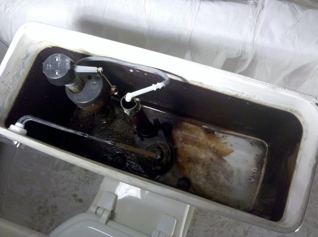

    The old toilet tank had a lot of sand and dirt in it, never mind the scale build up. Is this gonna be a problem? I'm not sure if its a problem anymore, as its been there for over 20 years, but what are your thoughts?

    Essentially all of the new low-flush toilets do NOT dump the entire tank when you flush...they use that extra height to give the flush more oomph (sort of like a water tower adds pressure). As a side effect, the incoming cold water mixes with the water already in the tank. Unless the toilet is flushed frequently, that water is at room temperature, and usually does not drop below the dew point. Now, this may not be true on some days. As long as the tank is not touching so there is at least a little air circulation, it normally isn't an issue. You can often 'fudge' the placing of the toilet on the flange a little to gain maybe as much as 1/4" or so; more than that and you risk seal problems and the bolts won't line up.
