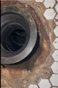

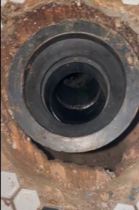

Okay so if you check the video, this is at my daugther's house toilet started to leak--took it off and found that the flange "ring" was rusted out like tin foil. So I removed it.
The wood rotted away or broke away at one end and also some rotted areas I cleaned up, but otherwise the wood is very solid no need to replace it.
So my plan is to grout or use some sort of quick cement around the flange. I will fashion something on the one end the large gap to hold the grout (probably a piece of wood dropped in vertically with a screw and wire attached then pull it back into place and screew in from the top to fill the large gap. Then I'll fashion something to make a nice "circle" around the pipe and then use grout/cement to make a nice even surface up to the level of the flange upon which to place a new flange ring.
Two options. The easier one is to order an "adjustable" ring so I can fit it under neath the plastic flange piece It has a groove where the old rotted ring had been. The flange top is a bit low (about even with the floor) but can use a Danco Perfect seal to adress that problem.
The other option is to remove the flange which is fitted over top of the 3 inch drain pipe and put a new one on.
So what do you think? I want to avoid the hassle of cutting out the old flange an reinstalling a new one but I can do that if it makes a significant difference in the quality of the install.
I also included a picture from underneath the crawl space. VERY DIFFICULT to get there and work there so I'd prefer to do all this from above.
I suspect you are describing a split repair ring
Sioux Chief 886-MRM is a split repair ring. May be galvanized. Not sure
Oatey 42777 Moss Bay is a split repair ring. Split repair rings
can go under plastic edge. Seems to be galvanized, even tho some say stainless
https://www.lifeandhome.com/products/william-harvey-014710-toilet-flange-repair-ring-1-4
Harvey's 014710 is stainless split.
Then there are the repair rings that go over the top.
PASCO 21013, Jones Stephens C85000, Oatey 42775, and Superior 21015 are repair rings with mounting tabs outside. Those have holes in the legs and holes in the ring part that can be used to hold the ring down. Then the repair flange itself can hold the toilet closet bolts down.

Thanks for the reply but what I am really looking for are ways to "sure" up the area around the flange without having to go back in the crawl space.

I'm not a plumber. I had a bad spot in the floor around a flange and I went under for my fix. I cut a piece of plywood to fit in the spot, cut a hole in the plywood big enough for the pipe to go through and then cut the plywood in half. Went under and placed the plywood while a helper screwed it from above while I held the pieces. Then I could securely mount the flange. I know you didn't want to go in the crawlspace but I think it's the better fix.

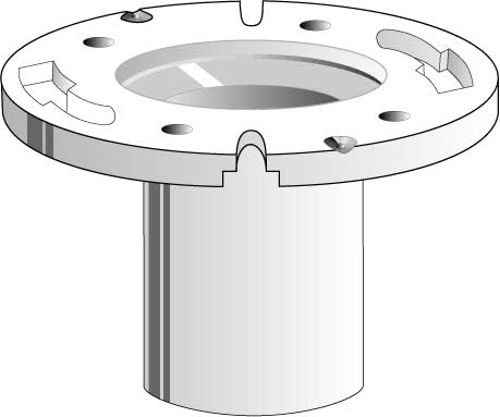

they make a flange with a long snout that would go down into that 3 inch abs pipe
its about 6 inches long and you simply glue it into the inside of the pipe.... let it set up
and it wont be moving again in our life times
and of course it has a metal ring that you can adjust correctly and maybe secure down to the wood that is
available.....
you could also saw off that old flange with a Dremil saw to get the new flange to seat
down into the cavity better.....
A closet flange has two main purposes. One is to hold down the closet bolts, and the other is to push up against the wax. The remaining plastic might be able to provide the up-push, but your idea of mortar under the plastic would certainly do that. Mortar is strong in compression.
So the part the mortar does not address on its own is the hold-down. You could put concrete screws thru the new mortar, but a repair ring with ears or Danco Hydro Seat would let you put screws into wood farther out.
If you don't get screws into good wood, I think you would need a solution that takes you, or somebody else, to the crawl space.

that will work if you cut it to size so it will go down in the pipe
the better option is the type that literally glues down into the abs pipe
good luck
I was never "keen" on the idea of reducing the diameter of the pipe from 3 inches. But when I tried the screw-in one it didn't work I "think" because the pipe takes a curve too close to the opening. I just couldn't get it to seal I could easily pull it back up and out. So I thought gluing one in but ultimately I decided it best to leave the flange opening a 3 inches.
