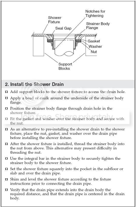

What does the drain manufacturer say to install with?
I installed a Kohler drain into my Kohler acrylic shower, and was instructed to use silicone, not putty. I've since read that putty is not typically used in acrylic tubs/showers, due I think mainly to the potential for staining.

In the case of my Kohler shower drain, the seal between the chrome drain body and the top-side of the shower pan does prevent external leaks, and is sealed with silicone as per Kohler instruction.

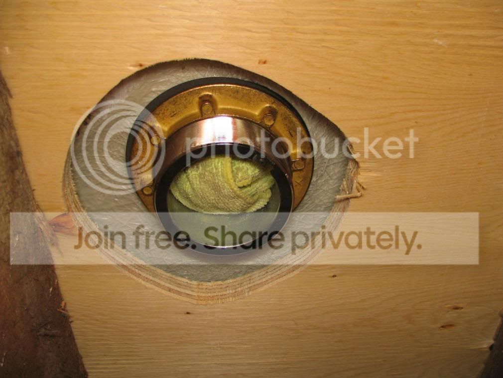

I too have a tiny tiny leak - about 1 spoonful of water every few days - the water evaporates out of the little tupperware container I have sitting under the drain between showers (opened the ceiling from below).
I will be re-setting my drain once the tub is installed next week so I keep a bathing facility active ;) I may look at this non-staining putty, but will probably stick with the silicone as it's my own fault the drain is leaking - a little off center and just wasn't liberal enough with the silicone I guess.
There is a foam gasket on the underside, but that just keeps the big nut from grinding on the underside of the base. There are no weeping holes to allow water that gets past the drain body/shower pan joint to drain into the drain pipe - maybe I should drill some ;)

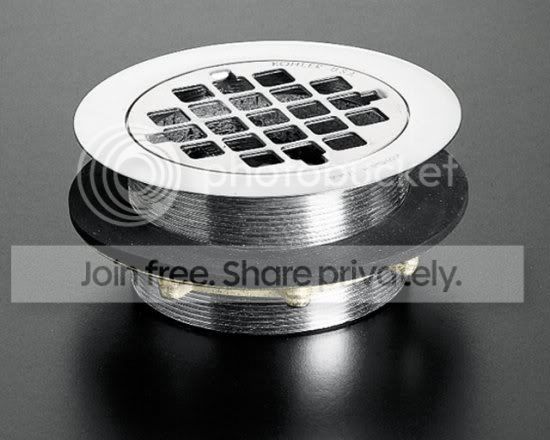

See, I knew I'd learn something today! I'll have to examine the drain for my clawfoot tub closely to make sure it goes in correctly. Acrylic clawfoot. I presumed it would be the same sort of drain as the shower, and actually think it might be at the end of the day.
This is the sort of drain that's going on my acrylic clawfoot. I'm sure drop-in tubs are likely different, but this seems to need a seal on the inside of the tub unless there's some mechanism for water that gets past that seal to be drained.
