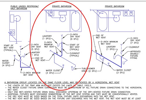

I am building a large detached garage in Washington state with an upstairs living area which includes a bathroom (lavatory, toilet and shower). After many hours of reading this forum and the UPC, I've ran through many different options to approach the drainage system for the bathroom. The most relevant diagram I've found is the middle one below:

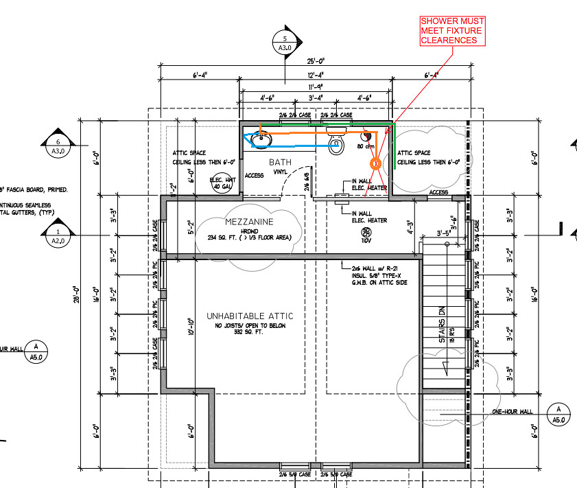

Here is the bathroom configuration shown on our plans:

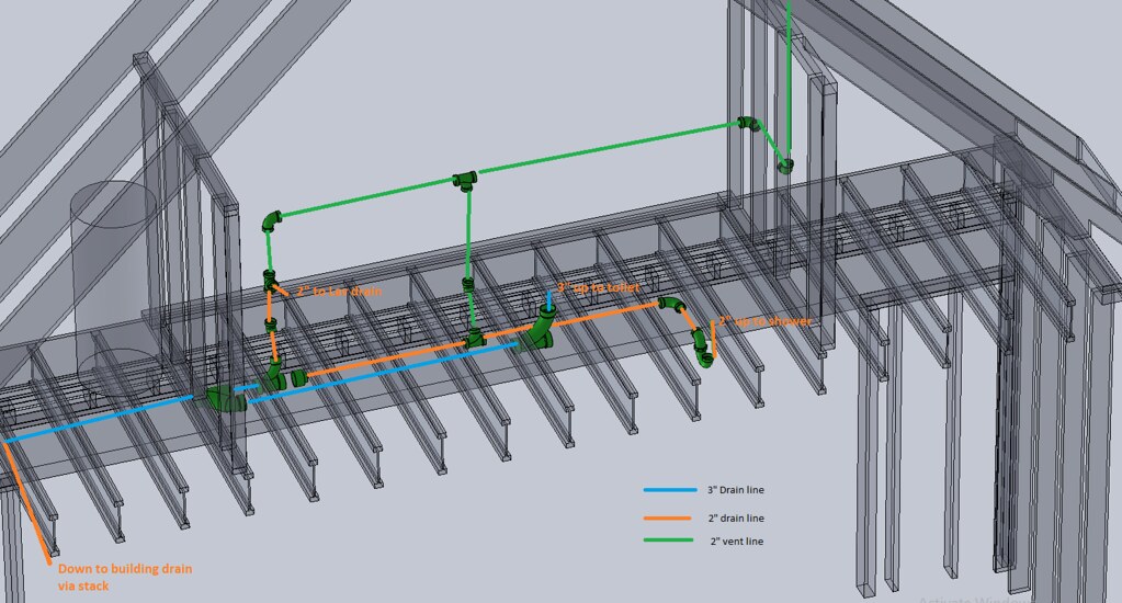

The bathroom is enclosed by a gable roof and sits on top of 3/4" subfloor and 11 7/8" TJI joists. I originally wanted to install the drain components through the TJI's, but have admitted defeat on that as all the pipes would be running perpendicular to the joists and I think it would get a bit to extreme with the amount of couplers and holes drilled through the joists. So I am looking to suspend the drain lines below the TJI's as they flow from the shower on the right -> toilet -> lavatory-> out to drain stack on the west (left side of drawings).
Here is a 3d drawing I've been using to lay the system out:
Garage plumbing diagrm 2
I am hoping to use a single 2" vent for this bathroom group that runs up through the roof on the east side of the gable (drawings are shown with typical north at the top). The shower is far enough away from the main wet-vent at the lavatory that I believe I would need the additional mid-length vent on the shower drain.
The toilet can connect down stream of the wet-vent attached to the lavatory and be within 6' per table 1002.2.

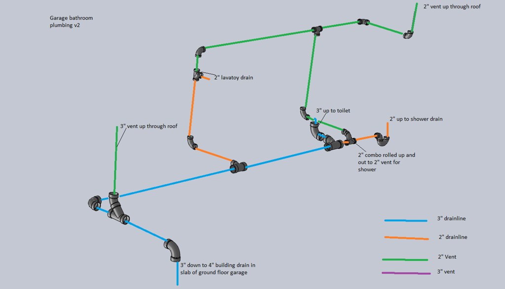

As for the combo wye that connects the lavatory wet-vent and shower to the main line I am unsure if it is acceptable to roll it up at an angle so that the lavatory drain connections can tuck away into the north wall?

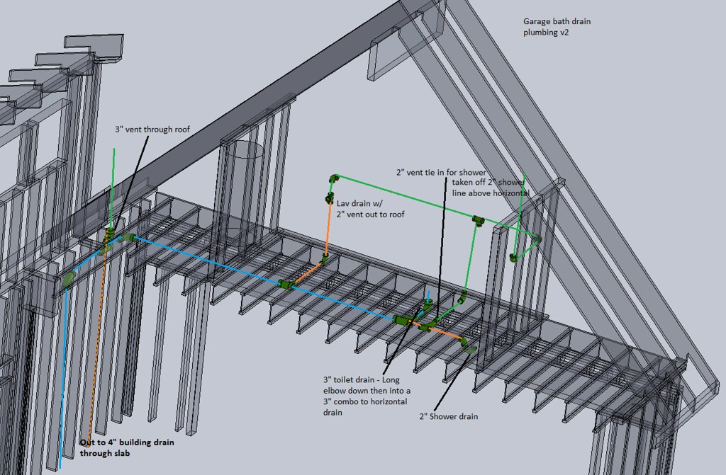

As it stands I guess my questions prior to going out there and drilling holes through everything are:
1 - Is it acceptable to have that vent between the shower drain and wet-vent connection in order to not violate the trap arm length rules?
2 - Is it acceptable for the combo wye at the lavatory/wet-vent outlet to be rolled slightly off from vertical to allow the upstream pipes to tuck into the wall? I am thinking I could tilt it off vertical then come up into the wall with a 1/16th elbow.
3 - Related to cleanouts - I might not be reading section 707.4 of the UPC correctly, but it seems like it is saying that clean-outs are not required on installations above the ground floor (I.E the building drain) is that a correct interpretation?
