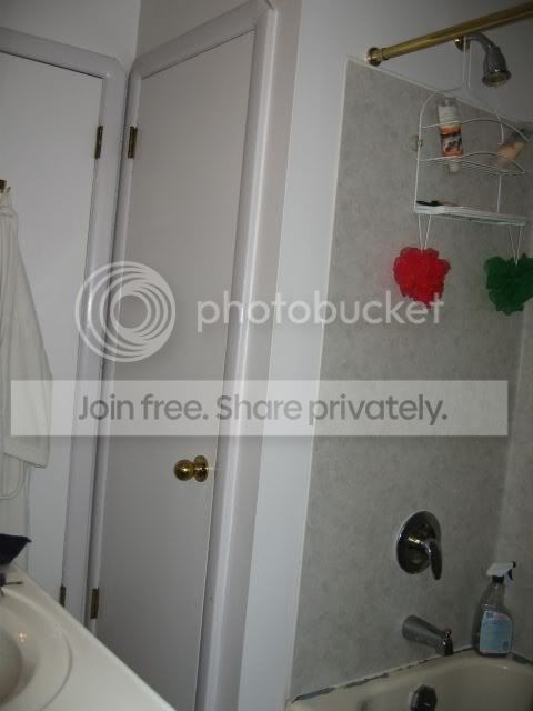

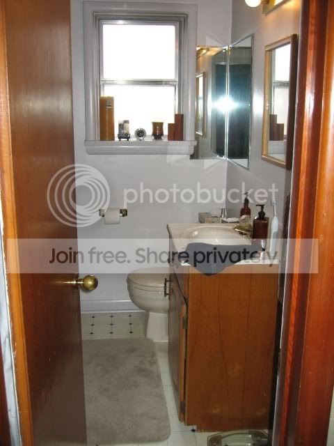

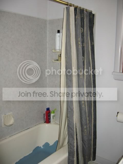

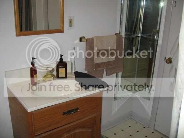

    The house is 55 years old. I bought it about 5 years ago. The previous owners had the cast iron tub painted a beige color. In the last 5 years I've had the finish on the tub repaired by the tub refinishers 4 times until they said it was off warrenty and I would have to pay to get it recoated. As you can tell from the pictures the tub used to be blue. The house is a 1 story house with a full basement. The floor in in the bathroom if vinyl but I peeked underneat it and it looks like really small tiles 1/2" x 1/2". The DWV piping is cast iron.

    Is the tub's finish the main reason behind a complete re-do? I ask because that bathroom still looks fairly nice in your pictures, and there are coatings you could use on that tub that are not going to come off.

    The reason for the reno is to update the look of the bathroom and the tub. I've had bad luck with this coating peeling away and want a deeper tub with air jets (the window also used to leak). After having updated all of the other rooms in the house this one really looks out of place.
