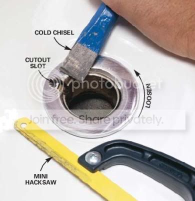

Now I am trying to get the drain out of the tub.. Holy Mackerel. Is there a special too to get the strainer out??

You can try using a dumbell wrench if there are cross bars in it.
Chances are it will come down to this....
Lowes does sell dumbell wrenches... Hopefully you can find a smockman that knows what one is...:eek:
Maybe google image it before you go....:D
