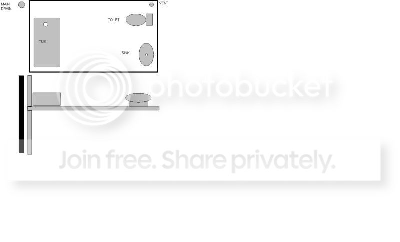

3" just to be on the safe side lol...
I got the toilet and sink figured out - the venting part.....I'm stuck on the tub part....
Problem is...everything sits on concrete floor and drains to main 1/2 floor below it...
Any ideas ?? Sorry ...my drafting skills are not the greatest :(
Again ...thanks for all the advice guys

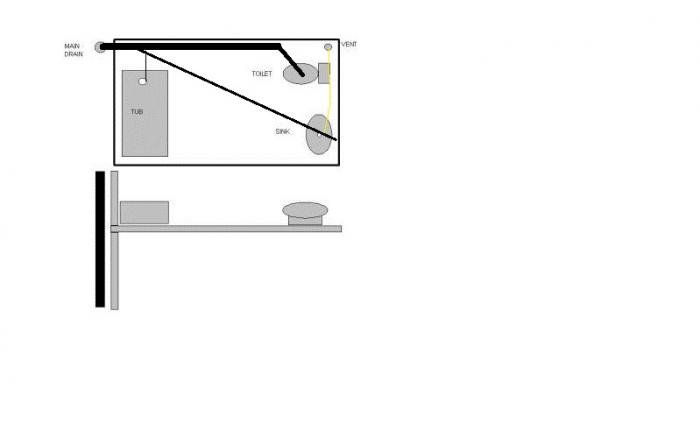

Shouldn't the laundry room have a vent in there? I'm not certain, and it's early here so I might have skimmed over some details. Couldn't the vent, which only has to be 1 1/2" tied into the laundry room vent somewhere.
At first I was thinking what others were too - drill the 2+" hole in attic and ceiling in basement and run the length of 1 1/2 up the wall and tie in up in the attic.
It's would require some precise drilling (multi measurements to be certain the holes line up. But that would be my route. With the AAV's they are permitted in Canada only if it's the only solution available... but with that said I've never put them on a setup with a tiolet. I usually keep them to island sinks (only when the other options are impossible) and bar sinks that people always add in finished areas)
Esquire
65
Newfoundland
I would run the 3X2 wye
3" run goes to the tiolet.
2"come off the branch of the wye
the 2" the has a 2X11/2 wye
1 1/2 goes to the bathtub.
2 goes the basin, goes vertical up the wall.
at your rough-in height for your sink drain I would put a 2X1 1/2X1 1/2 T
The 2" line wet vents the tub and tiolet, the 1 1/2 above the basin drain becomes the dry continuous vent which you have to connect to the main vent somewhere.
