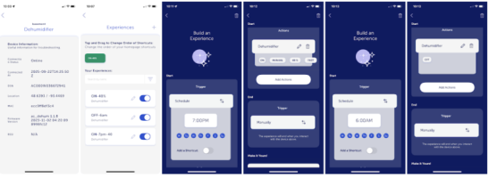

I am having reliability issues programming the NOMA iQ iOS app. So far, I've not found any online community that supports the app. It looks like I will have to rely on phone support.
I am trying to set up the iOS app on my phone to schedule the dehumidifier (CTC #043-8820-8) to run only during the HydroOne off-peak times from 7 PM to 7 AM and cannot get the app to work reliably. The app sometimes doesn't start or stop.
The app also has other inconsistencies and sometimes crashes. I gave up on the "End" section and created a second Experience to stop the dehumidifier but it does not work consistently either.
On the Experiences page note that while the use of the % character is allowed in the name "ON40%", it is forbidden on the name "ON-7pm-40%".
While editing an Experience, the time and days on the "End" section are not kept and keep changing. Likewise on the other fields.
The last two days it was on its best behavior since I have not interacted with any saved shortcuts on the Experiences page. My guess is that the invoking the shortcut messes up the in-progress schedule as it acts on it right away and not when scheduled. Also guessing that editing the "End" section while the schedule is underway messes it up.
That was short-lived. Last Sunday we had a scheduled power outage that ended at 5:15 PM but at 7 PM the dehumidifier failed to come on and had to be manually started. It shut off in the morning automatically on schedule and also resumed the schedule Monday at 7 PM. Then again last evening it failed to start but this time there was no power interruption to attribute it to and I did not manually start it. Time will tell if it starts this evening.
Well, phone support was useless. While the dehumidifier is a portable unit, unplugging it messes it up so it is lousy programming. Even if I don't move and unplug the unit, if there is a power blip, one cannot rely on the program recovering.
