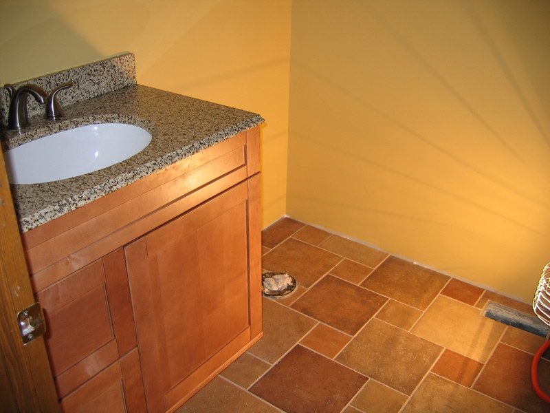

I've been reading Terry's and other's impressions of the Aquia toilet and think it sounds great.
That is, until I read that installing it requires drilling 6, 1/4 holes into my recently tiled floor. Quick aside: I'm one of those fledging DIYers who takes at least 8x longer than anyone else. So the though of drilling into my floor seems awful. Just checked with my wife, she assuremed me that I take 10x longer. :)
Is this difficult enough that I should look at the Drake instead?
From what I've seen others say - to drill into tile you should:
  1. use clay to build a little dam around the area to drill
  2. pour water into dam
  3. drill slowly
Any other suggestions for those that have done this before?
Is it sufficient to buy a carbide tile drill bit from one of the big box's?
Thanks much

ChrisG
9
North Carolina
Joerg
138
Califonia
Hello Chris,
Nice job. Looks like you'll have to drill close to the grout on some tiles. Seriously, I'd consider a toilet that can be flange mounted like usual. Otherwise I hope you had back-buttered the tiles when laying so there won't be any hollow spots where you'd have to drill. A mortar void under a corner would almost be a guarantee for a crack if you have to drill there.
Regards, Joerg.
