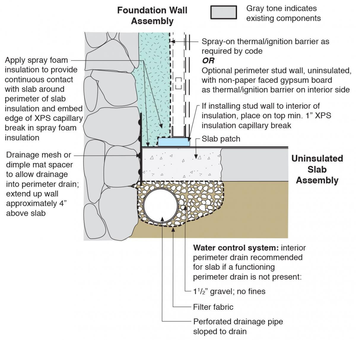

The heater on the first floor is one of those vent free ones that they sell at the big box stores that doesn't vent out sits on a floor stand. A friend loaned it to me to use. The first floor is vacant, and the boiler was leaking very badly between two sections. I just shut it off and drained it, and am using the heater to get by for now, just to get some heat in this unit. It is hooked up to my meter.
I've been researching a few sites on the spray foam. One question I do have is will any trapped moisture in the stones or bricks freeze in the winter? Could it freeze and damage or cause the bricks to crumble? Right now most of the efforescence I see is inside, not so much on the bricks outside. Some of the bricks are crumbly now probably will have to be repaired or replaced. There is old paint on the inside, some peeling off. Can the foam be sprayed right over this? I'm thinking I will have to do some repairs and tuckpointing before. The stone is solid except some of the mortar in places is loose and seeping. Would parging the brick be a good idea?

Freeze thaw spalling of the brick is remotely possible in your climate, but not likely. It would be of much higher concern for brick buildings in places that are actually cold, say Winnipeg. The porosity and hardness of the brick is also a factor. If it was going to be a problem it's likely that you already have a few places where it's spalling. Decent roof overhangs (preferably with gutters) to limit splash-back wetting, and paying attention to surface grading/drainage to keep the near-grade soils near the foundation dry is usually more than enough to keep foundation brick from spalling in a US climate zone 5 type climate. (I live in a comparable climate, and have yet to see spalling issues on a foundation that was related to insulating and sealing the interior, though I've seen minor spalling related to chronic splash-back wetting.)
While it's better to clean up any loose crud on the walls first, at 2" the foam itself is fairly structural. as long as the surface of the foundation sill and the top of the foundation is fairly clean it'll be fine.
Talk to a competent mason as to whether a parge would do any good. The original mortar type and the type of brick make a difference. It can go either way. The 1890s house that underwent the deep energy retrofit had a mortar that a sacrificial parge wouldn't even stick to, they just touched up the mortar using a hard portland cement & sand type of mix and sprayed directly on the brick. It shows no signs of spalling despite parts being buried in heavy snow-drift 2 out of the past 3 winters. (Last winter there was 10' of snow in that neighborhood which was a near-record, 9' of which fell in only 6 weeks.)

It's fine to foam all the way down to the slab despite the seepage, but it sounds like you have some bulk water management issues on the exterior that are worth fixing even if you don't insulate. Grading the perimeter to slope away from the foundation, and directing the gutter output somewhere several feet away from the foundation would be a start. Without knowing the particulars of the yard it may or may not be necessary to dig in a surface drain along the perimeter on the exterior.
If you still get seepage after fixing the water management on the exterior, the common remedy which is more expensive, to be sure) is to install an interior side drain along the perimeter of the slab, directing seepage water to a sump:

Funny you mentioned cut up cardboard boxes, because that's exactly what they had over some of the open stud bays! Most of it disintegrated when I went to remove it to run new wiring. Some pieces of it dated to the 1940s. Only the center loadbearing wall and the outer walls in the attic have top plates, all of the interior partition walls, including the bathroom wet wall are open to the attic. Second floor joists are also open to the stud walls at the ends. I have sealed most of the open stud bays in the attic with foam board and spray foam, still have to do the wet wall yet. Also notice a lot of warm air coming through the 2" air space surrounding the chimney. Once I take it down I can cover up this chase and stop much of the stack effect. If I can say anything good about balloon framing, running wiring is a breeze!
I still would like to do the basement walls, just want to be sure any moisture won't affect the insulation and cause mold. Somebody already put fiberglass in the rafters and drywalled it. I don't think this was the proper way to do it (isn't there supposed to be an airspace between the insulation and the roof sheathing?) but not sure I want to tear down all that drywall and remove the insulation already there. First I'm going to finish air sealing and insulating the joist bays.
