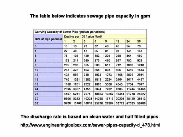

My question is how much capacity is a 4" pvc line capable of handling? I've seen 4" lines going out of apt. buildings, and am wondering what their capacity is.

There are plumbing charts that you can google that tell you all that fun information.

You will notice in the chart one peculiarity of geometry. At almost all points on the chart a 4" pipe has approximately twice the capacity of a 3" line.
