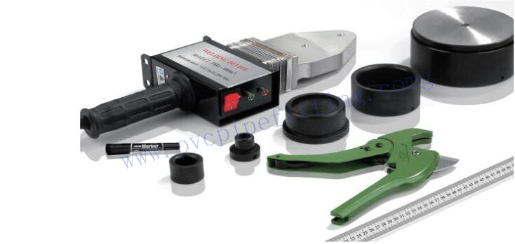

1. Prepare PPR pipes and fittings before installation
A. Before installing water pipes, prepare some tools, such as splicer, scissors, marker, ruler and clean wool cloth.
B. The melter needs reliable grounding measures.
C. Installation of welded joints and inspection of correct specifications, strong and reliable connections before electrification;
D. The red light indicates that Jiawen is on, and the green light indicates that it can be fused.
E. Check whether the specifications and sizes of pipes and fittings meet the requirements.
F. Underground application is not recommended for general household installation. It is recommended to use wall-embedded or ceiling-embedded undercover application.

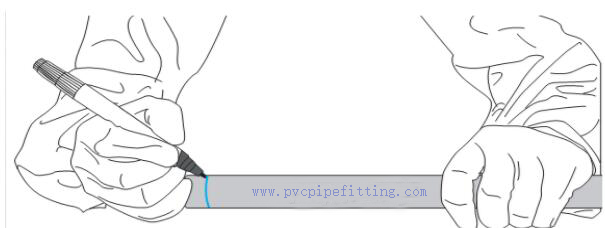

3. Deep Drawing of Fusion Joint of Household Water Pipe
Before welding, it is necessary to draw a circumferential line along the longitudinal length of the pipe not less than the minimum socket depth L2 on the surface of the pipe.

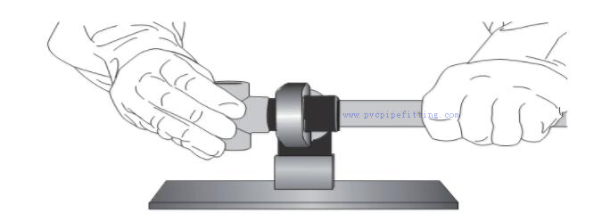

4. Installation of Pipe Welding Heating
A. Push the key ppr pipe into the weld die sleeve and core at a uniform speed, and push the pipe to the mark line, the key advance depth to the end face of the socket and the end face of the die core.
B. The phenomena of not rotating and tilting in the course of propulsion;
C. The heating time is regulated according to the standard. In winter, the heating time is generally prolonged by 500%.

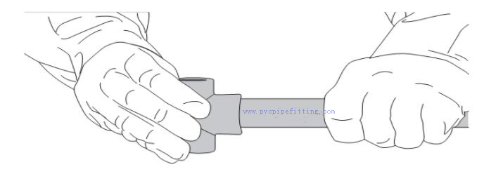

5. Docking insertion and adjustment
A. The butt insertion speed should be as fast as possible to prevent premature hardening of the surface of household pipes;
B. The angle adjustment of butt insertion may not be greater than 5 degrees, but it must be completed within the prescribed adjustment time.
C. Relative rotational motion between pipes and fittings is not allowed during butt insertion.
