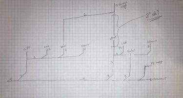

I am updating a pair of adjacent bathrooms, and am hoping to vent with 2 inch as shown (step up to 3 in attic to exit through roof). Is this sufficient or should the vent in question be maintained at 3 inch all the way up? Single story home in Rhode Island. Thanks

Knowing how cold RI gets, I would go through the roof with 4" to prevent hoarfrost

you have a good point, run a 2 inch vent up to the penetration through the roof and
then increase it to 4 inch........ we used to increase a 1 1/2 vent out the roof with a 3 inch increaser
and never had any issues

NYC always required a 4" penetration through the roof; even if the vent was 11/2" it had to be increased to 4" when going through the roof

https://codes.iccsafe.org/content/IPC2018/chapter-9-vents says
903.2Frost closure.​
Where the 97.5-percent value for outdoor design temperature is 0°F (-18°C) or less, vent extensions through a roof or wall shall be not less than 3 inches (76 mm) in diameter. Any increase in the size of the vent shall be made not less than 1 foot (305 mm) inside the thermal envelope of the building.
My point was that the increase should not be right below the roof if this is a really cold place. I doubt that NYC is that cold for this purpose.

Its never been a problem to throw a 36 inch piece of 3 inch PVC through the roof flashing with half above and half below in the attic then reduce it down to 2 inch or 1 1/2 it always works just fine and dandy
very , very rarely is this gonna freeze over ,
maybe during a polar vortex lasting a week or more. you might notice a sluggish drain
but its only gonna be temporary thing...
something like a fart in a breeze

Thanks everybody. Picked up a 4 inch flashing today. Looking forward to removing the old vent chase and getting some needed space back.
