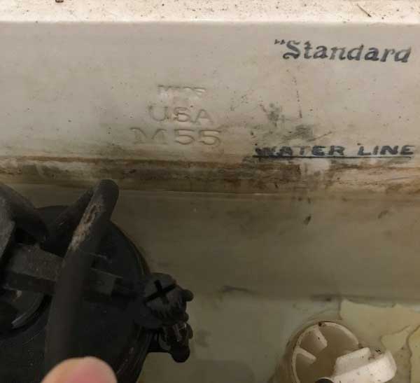

I need to replace a toilet tank lid but I don't have the old one so I don't have a part number. I've posted some pics of the only part numbers or brands listed on the rest of the toilet, but I still cannot identify the model number or find the part number for the replacement lid. Please help!

It is 60+ years old, so the ONLY place you might find it is at a second hand store or the site which specializes in tank lids.
Is there any way to identify the toilet from these numbers, which I guess amount to some kind of serialization or model numbers? Any way to know the part number for the tank top?

Still, in order to search any such secondhand store as you have mentioned, I would need to know the model of the toilet or the part number of the tank lid. Is there any way to determine the model of the toilet based on the serial numbers in these pictures?

It probably uses 5 gallons of water and the bowl is a "washdown" model which has basically been obsolete since the 30s even though they were still made for decades after that. Standard (Sanitary), was the original name, then it became American Radiator and Standard Sanitary, and finally American Standard. So your toilet tank which is probably a model #392, (later an F-o392), is well back in the lineage of the company.

Try this store (for a reproduction, not original.) It'll probably set you back $75 + shipping.
But for less money you can probably find a pretty good used code-legal low volume flush unit on the local craigslist or Habitat For Humanity Restore. Even with a new set of gaskets, flapper & fill valve, flange & wax seal it'll be about the same or less than a reproduction lid for the "mid-century modern" antique. Unless you really LOVE the thing, it's not worth investing any money in it.
If replacing it, measure the distance from the floor bolts to the wall for the rough measurements, and get something similar. There were still some 16" rough toilets then (don't know if this was one of them), which are a bit rarer today, where 12" rough-in dimensions are most common, but there are 14" & 10" versions too.
If for some reason you're keeping it, Plumbing Supply has the internals & gaskets, but not the ceramic components.

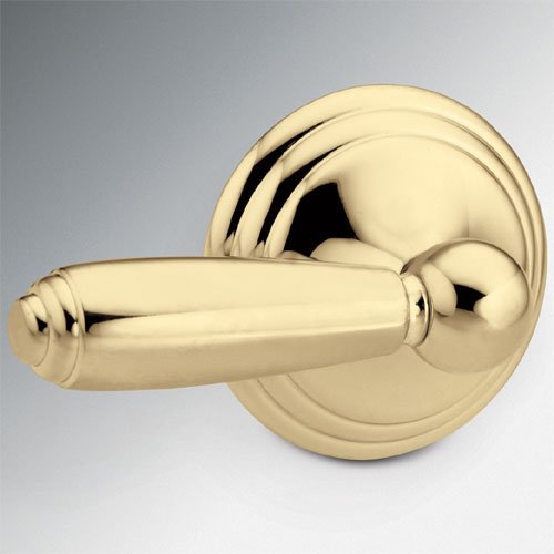

One wrinkle was that the flapper chain wasn't long enough, so I just stole some chain from a flapper I was tossing away and attached it to the chain on the 50BP. A little adjusting of the length to get the thing to flush reliably every time, and voila! I also dressed it up with a Moen handle that I don't think they make anymore, which had a lot of leverage to seamlessly lift the flapper under the huge water column in this thing, which the old handle struggled to do.
It was:
Moen DN8401PB CSI Preston Tank Lever (Turns out there are still a few available online.)
