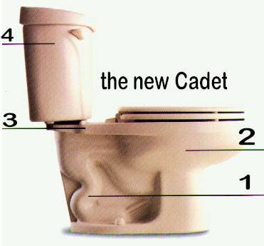

I haven't tried the Sterling Windham and have no oppinion on it. The Kohler Wellworth is not a strong performer. The Cadet II, seems to work fairly well, and I would guess that the "New" Cadet EL with the siphon jet will do better. I have one in a box that I have been meaning to install at home for testing.
If at all possible, get the elongated version. They will make the bathroom look better and are easier to use.
