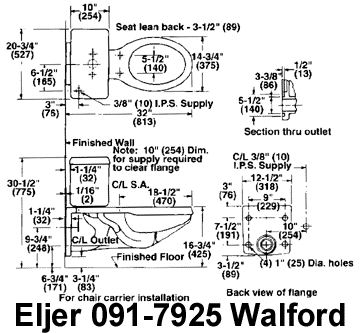

: I'm interested in toilets that are attached or connected by way of the wall instead of thru the floor anybody has those types? please contact me.
There are two types of wall mounted toilets,
1- floor mount rear outlet, (mainly Flushmate equipped with elongated bowls by Gerber, A/S, Kohler, Crane
2- Wall mount only, the toilets set inches above the floor (mainly gravity or PF/2, Crane, Eljer)
We have been waiting for a good 1.6 wall hung toilet to arrive. If anyone has found success with any of the the new ones, let us know.
