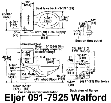

: I have wall mounted toilets and would like to have the new PF/2 Energizer flush system installed. Do I need new toilets or can the old ones be retro-fitted? Who makes a Pressure Assisted Wall Mount Toilet?
Replies to this post
There are none.
