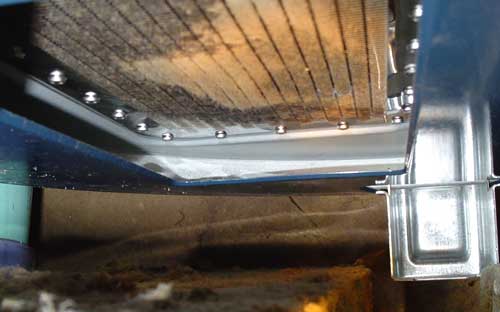

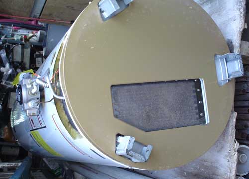

What is the basic design flaw in the Whirlpool Gas FVIR water heater????

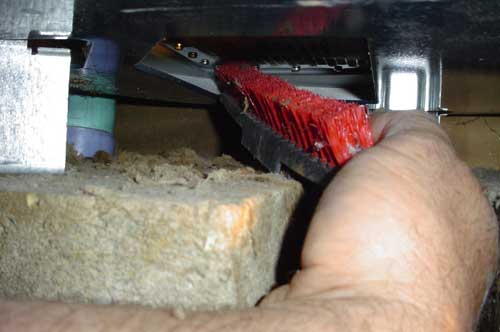

1. The  AIR INTAKE screen is small, and over time can clog with lint, dust, and hair.
You must  clean the lint off  from the bottom of the unit and from inside the heat chamber every 3 months or it will not get  enough air to operate correctly.
2.  you cannot  buy replacement parts that will fix this "built in design flaw" once and for all.
3.  This brand sucks up lint like a vacuum sweeper,  and then gets starved for air..,
install  Whirlpool in a dusty, linty laundry room and  it will certainly fail.

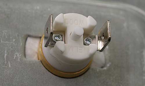

4.  Their new improved  "thermal fuse design"  upgrade  is no improvement at all ,  it overheats and burns out even quicker than the original design.   If there is any downdraft that happens when your furnace comes on it can kill this fuse.

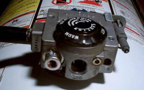

Tampering or  " jerry-rigging "  this unit to make it work is a Liability and Safety hazard and should not be done .   It is unsafe for financially strapped home-owners to have gas valves and gas burners mailed to them,  and then be expected to repair the heater themselves.
6.. look at the junk sucked up into  the bottom of the air screen on this Whirlpool heater

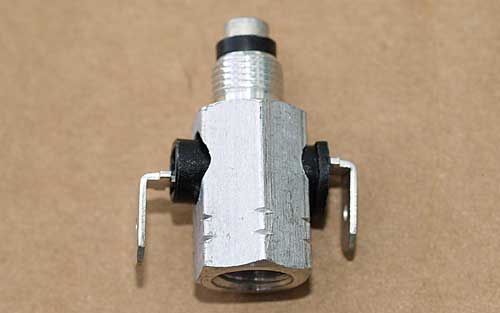

They sent out a replacement thermocouple, but for some
reason, in the next few days I also received a box
with another thermocouple plus regulator unit. That's
strange, since I never reported a problem with the
regulator.

So in answer to your question, no the problem isn't
fixed in the "proper manner". But because I don't see
any immediate or critical safety issues I'm going to
leave the plug out as an experiment to see if it
corrects the problem. If it doesn't I would think
that there is more to this issue than a throttled air
supply from a dirty screen. It's strange that I
haven't seen anything on the .gov sites about this.
Maybe the feds aren't aware of the problem.
