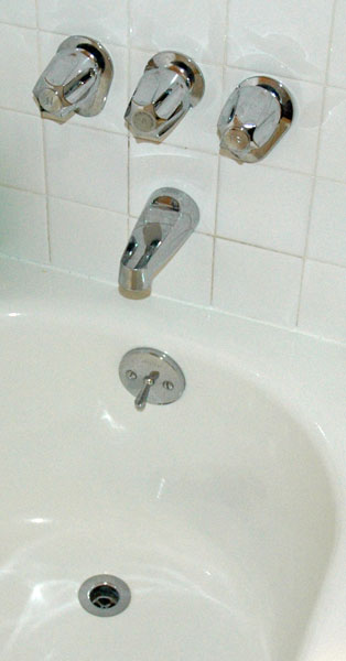

Price Phister Three valve tub/shower diverter

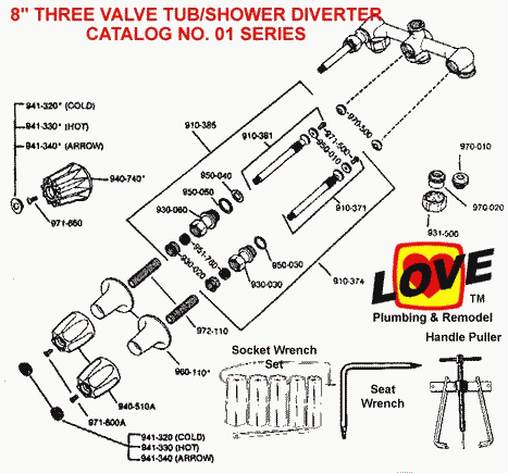

Make sure the water is off at the main shutoff.
1. Remove handles with a faucet puller.  Remove trim.
2. Remove faucet stems with a socket wrench.
3. Remove seats with a seat wrench.
4. Replace seats with pipe sealant on the threads.
5. Install new valve stems.
6. Replace trim and handles.
