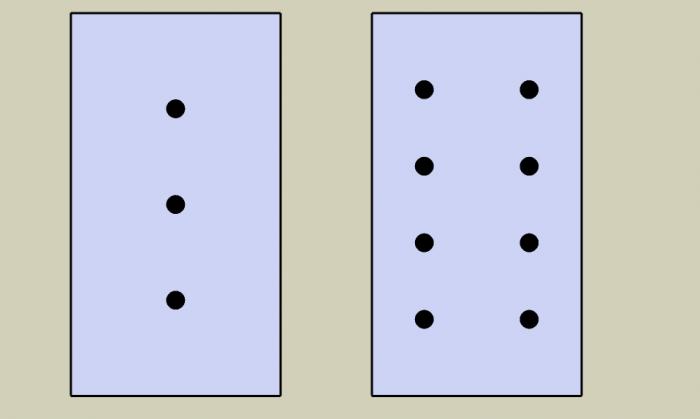

lights
I would prefer them out far enough so that they do NOT cast a shadow line, or at least a very narrow one, on the counter top when the undercabinet lights are off. For a 9' ceiling height that would be about 3' from the face of the upper cabinets. A bit further for an 8' one.
I also like to place the lights over "work centers"
centered over the kitchen sink
centered over the frig.
centered over the pantry
Pretty much anytime you have a double door opening, I place one in the center.

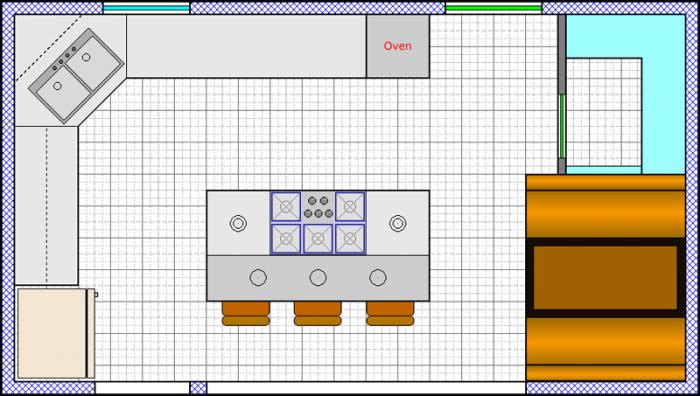

I don't install cans unless I can see the cabinet layout first.
Here's the basic layout. I'm most interested in the lighting over the counters, (light gray areas), and the sink.
kitchen layout (Right-click to open in new window.)
The "brown" area is my poor attempt at a banquette artistry.
(Blue line is a window. Green lines are pocket doors. Cyan area is a pantry.)

One major consideration is the ceiling height since recessed cans project a "cone" of light, and even that is variable depending on the design of the can, rather than a general flood.
One simple way to tell if the light will hit the back of the counter is with a straight edge
Put a straight edge (4' level) at the back of the counter & bring it up until it hits the bottom of the cabinets
The extended line towards the ceiling will mark the spot where the recessed cans should be in order to light the back of the counter top
My 4" cans are between 10-14" from the upper cabinets

I'd put them 24" from the wall. Or 25". Since you have a ceiling and not a header; otherwise they have to be in the header, which can be smaller. So, directly overhead. Your head is not closer to the wall than the edge of the counter 26" from the wall, since you are standing upright, not leaning forward. So you don't need to worry about lighting the back of your head and causing shadows. They have to be the kind that can be directed to turn an itsy bit. If you put them a couple inches farther from the wall, it's still good!
Spotlights. Even a narrow one, like an MR 16 with 12.5 degree spot light, still produces a big light spot on a counter, when the ceiling is 7 1/2' and the counter is 3' high. About 24" - 27" apart, more or less, perhaps depending on your wall cabinets or another factor not yet shown.
