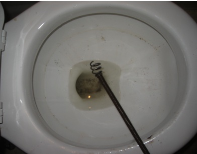

Question Ain't no sunshine till it's gone
After searching the forum posts, I realize the toilet is clogged. And a snake is the only solution. Question - how do you get the snake into the toilet drain?

Default snake
With THAT snake, the answer is YOU DO NOT. At least you do not unless you want a toilet with deep scratches on the bottom.

Well, first, you clean the toilet up nice and shiny before you post a pic in a public forum.
Seriously though, I believe I've seen somewhere, a type of "sleeve", that you insert part way down the throat there to protect the toilet from the snake. Can't remember where, or what its called. Perhaps Google.

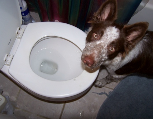

K, Better Artie?

Get yourself a closet auger. It has a bend and a protective sleeve. Next step if that doesn't work would be to pull the toilet and either try to dislodge whatever is in the toilet from the bottom, or use the easier access to get down the drain.

Artie Artie is offline
DIY Junior Member
Join Date: Nov 2009
Location: Jacksonville, Fl
Posts: 17
Quote:
Originally Posted by Intrepid View Post
K, Better Artie?
Oooh . . . you didn't let that puppy lick it clean, did you?

Default puppy
Yes, and he gave a big kiss on the lips afterwards to show his appreciation.
