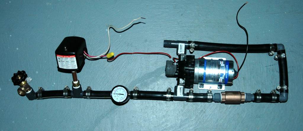

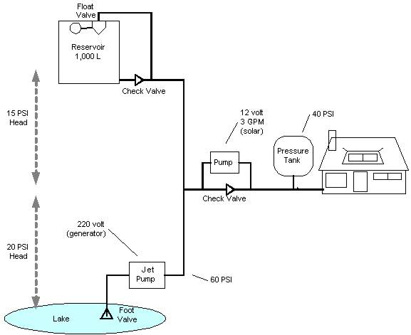

I'm building a water system for a rural cottage/cabin to augment the existing generator powered pump. I want to add a 1,000 litre (250 US-Gal) cistern and a solar powered pump to give us a water supply and some pressure when we're running off battery.
The general layout is shown in the diagram. The pump itself is in the attached photo.
I've added a bypass to the pump so we'd still get low-pressure water from the cistern, even if there's no bettery power for the pump.
The water in the lake is not potable, so this is just for showers, dishes and washing.
Have others set up this sort of thing? Any pointers?

the plan is good , but the results could go haywire..
you could almost do the same thing with a sump pump
and a garden hose..
depending on how clean or dirty that lake is
could be a very big ssue.....cattel or sheep in the area
or septic run off from other cabins......
you probably should not do dishes with the posibliiity
of any kind of microbes that could make you deathly ill
, even bathing is very questionable because getting any
water on your mouth could lead to big troubles.......
I got a bug once in the mountians once and it was not good....
I was down for oveer two days
but for flushing toilets it is ok....
and perhaps it would be ok if you plan on pouring some bleach into
the cistern to kill off everything when you arrive at the cabin...
and then remember to do it daily while you are
staying there....
you would certainly want to keep a supply of bleach on hand
its your risk.

The jet pump and in-building plumbing have been in place for years. People have been swimming and showering in the lake water with no serious problems. I do recognize the dangers of using the water for dishes and whatnot. Probably the most important danger is Giardia in this area.
I have been vaguely considering a UV sterilizer as an option. Giardia is quite susceptible to UV, and tolerates chlorine. In this case, the water would come up from the lake from the pump, through the sterilizer, then on to the cistern/cottage.
The problem I'm trying to get at here is that when the generator is off, we have no water at all. The fact that it's lake water -- well, status quo -- until we can afford to have a well drillled.

If you put a chlorinator to work with the jet pump, you would have a metered system to add chlorine to the water that is going to the storage tank,
Increase the size of the pressure tanks or series a number tanks, you would have more draw down, or If you could raise the stand or place the storage tank up higher elevation, You could increase your gravity feed pressure.
one other idea, would be to use a large pressure tank for your pressure water storage or a series of them that were galvanized or lined an no bladder, and instead of a pressure pump, use a small 12 volt air compressor and after filling them,
turn on the compressor, (have a 40 psi top pressure switch, and when the water is used, it kicks on pumping air in for the water is displaced, a few 80 gallon tanks would give you 160 gallons, of pressurized water draw down, when empty, open a valve and release the air let them gravity fill, and start over again, (I borrowed a old RV one time that used this type of system)
a cheap source for tanks would be used hot water heaters that have good tanks, (old electrics I think would be better than gas),

The only requirement I'm aware of is filtering -- I think 5 micron is the requirement. Is there more I need?
The problem I see with UV is that we won't have enough juice to run it all the time. Even at 20-30 watts, the batteries will not keep it running indefinitely. It would wind up having to be connected to come on with the main pump when the generator's going and hitting the water on its way up from the lake.
The pump should be able to fill the cistern at ~20 US-Gal/min and that would take a pretty bug UV sterilizer -- a Trojan type E or so.
The lifetime of the sterilizer is reduced a lot when it has to go on and off, and the effectiveness drops, maybe hopelessly, when the lines remain connected around it when it's off. Perhaps a check-valve just upstream from the sterilizer would be good enough to prevent unsterilized water from difusing up the pipe. Finally, the sterilized water is then going off to our cistern where it will sit for days, maybe weeks. At this point I don't think anything truly harmful would be growing in it, but who knows.
Another option might be a single-fixture UV sterilizer attached to -- say -- a "water purifier" in the kitchen.
I'm curious what would be typical in an off-grid setup where people are using UV sterilizers.
