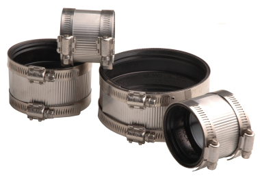

Who do you call to ask if something is allowed or code legal in your area? Can you just call a plumbing business and ask or do they not like that? Just don't know who your supposed to call to ask a question like that? I want to call and find out if I can use transition cement for ABS to pvc or do I need to use no hub couplings. Thx.

You local building department will have information on plumbing codes.
You will be able to buy a permit and talk to the local plumbing inspector.
They can be very helpful.
It's what we do.
When I was plumbing meat markets around Puget Sound, it was the first call I made. Sure I had approved plans, but it was important to talk to each inspector in each city to find out what he expected. I think I plumbed eight of them for the same grocery store, and all eight were plumbed a little different.
You will need to use shielded couplings to transition between ABS and PVC

Here in San Diego, the permit office has "homeowner" Saturday hours where you can take plans in for review and just ask questions.
If you find out what code you are under, then lots of pretty good advice can be had on the forum, but the last word is always the "local book" so to speak.
