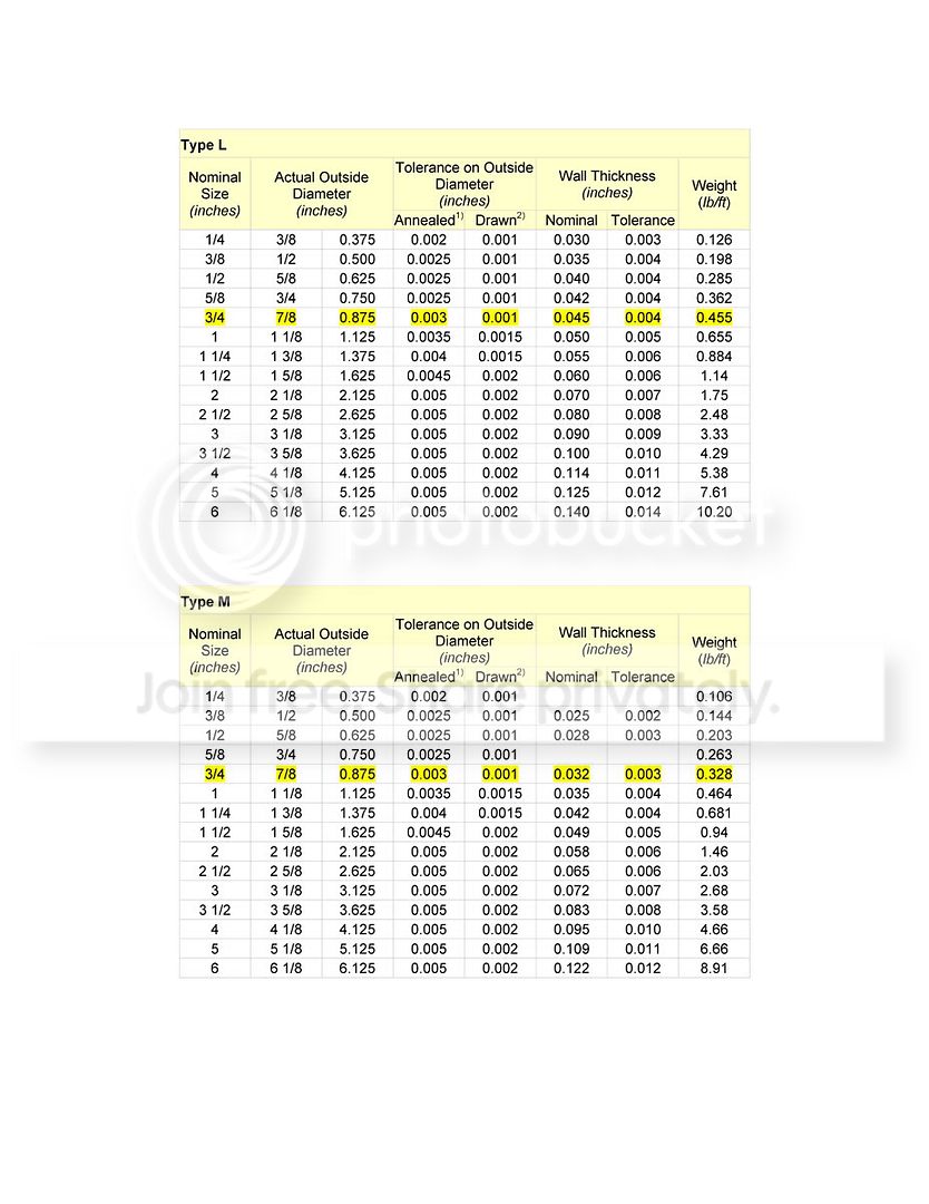

I'm planning on replacing 1/2" supply lines with 3/4" supply lines for a shower remodel.
I was wondering what's the difference between type L and type M copper pipe and what type is recommended for hot and cold water supplies?

It is the wall thickness. Most of the towns I work in want Type L copper.
