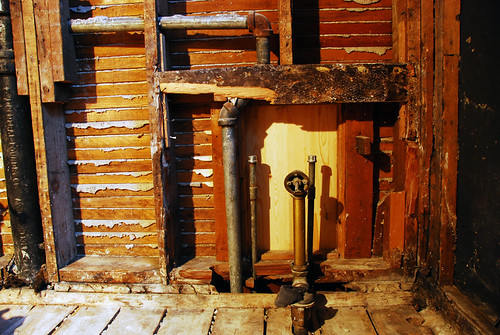

Yes, I want to wet vent into the stack. The stack is old cast iron - not sure of the diameter but I'd say at least 4". The toilet actually connects to the stack at the exact same height as the tub drain.
This is a main floor remodel, and originally the tub connected at this same spot, but it also had a vent pipe connected a few feet up the stack (visible in this photo and shown in red in my awesome diagram).
The toilet is just off the left side of the photo frame here. You can see the shadow from the flange.
I thought that I could get by with a wet vent, and maybe that would allow me to use the stack above for waste if I ever wanted to put a second bathroom in above this one. But I guess if I can't have a toilet upstream of a wet vent, then I might as well go back to the original vent or run a new vent all the way to the second story?

Well then with them being symmetrically connected like that you are actually ok in doing what you're doing.
But you MUST make sure that the toilet and the tub tie into the wet vent through the same fitting (IE double wye).

What he has is proper for HIS drain system. He cannot convert the main vent stack to a sewer/toilet drain stack by putting a vent on the tub drain. To do that would require a complete revision of the drain system, which might be more expensive and difficult than just running a new sewer pipe to the second floor.
The tub drain and toilet pipe enter the stack at right angles to each other. If you're facing the wall, the toilet drain goes straight into the face of stack, and the tub drain enters from the right side.
The photo dlarrivee posted clearly illustrates why you'd want the fixtures sharing the same fitting, as the openings direct flow away from each other, but this wouldn't be an easy conversion for me. If I put the vent pipe back where it originally was (the one in the photo) will I be OK?
Is the tub drain more vulnerable to flow from the toilet as a wet vent? Is this even considered a wet vent if the fixtures connect at the same point?
