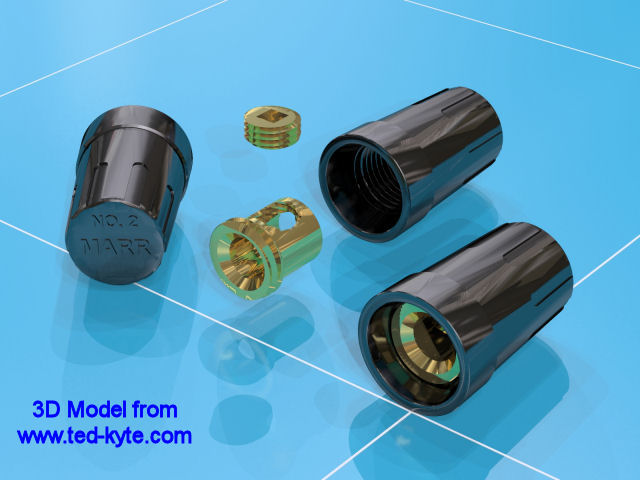

Originally I had the twist-on kind but it kept fraying the stranded wire whenever I would break/make the connection. Finally I tinned the stranded wire with solder and switched to Marr connectors.

A pump man would use un-insulated butt splice connectors and heart shrinks or good electric tape, the same as if it had been an underwater splice.
Ooh, those I like. Thanks for putting a name on them.
