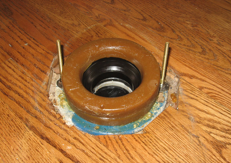

95% of the time in the Seattle area, the flange is lower than the finished flooring. The easy fix is two wax rings stacked, and the bowl set down over that. I use one regular wax ring, and then a horn wax over that, then the bowl drops down.
Some of the rubber seals on the market are a single thickness which may not work unless the flange is just the right height.
Some rubber seals require a new clean bowl to adhere the glue to the bottom of the bowl. If there is wax from a previous install it may not work.
The height of the flange makes a lot of difference in what can be used.
The flange is lower than the floor, two wax rings.

Let's work backward on this. When properly installed, the flange sets on top of the finished floor. With the flange in that position, a regular thickness of wax ring is all that is needed. Now, that the ideal install. But in the real world sometimes the flange may set below the finished floor. That's what Terry is referring to. There may be reasons for this, but unimportant for this discussion. The answer to your question then is it just depends on how far the flange is below the finished floor. If the flooring was replaced after the flange was set using thick tile, it could be you'd need a couple of rings. However, if the new floor was just a new layer of vinyl tile, perhaps just a supersized wax ring would be enough. The distance above the floor will not be "inches". It has to be high enough that the horn on the base of the toilet will compress the wax to make the seal. Just remember that when the flange is set on top of the finished floor, a standard ring is enough. So, if your flange is lower that the top of the floor, you need that much more wax ring thickness. Probably better to have 1/4" too much than not enough, and remember rings come in several thicknesses.

When you set the toilet, if you don't get some resistance as you smush the toilet down onto the wax, you don't have enough! You can measure the depth of the individual horn of your toilet...place a straightedge across it, then measure how deep to the top of the bowl where the wax will go. Compare that to your wax ring. The reason why Terry suggests two wax rings when low with the top one being with a horn, is that the horn helps to line the two rings up and prevents any excess from mushrooming into the opening of the toilet discharge. Having a regular wax ring on the bottom helps to ensure you don't end up with only the plastic trying to make the seal, verses the wax if the tolerance is too close or the funnel (horn) collapsing into the neck of a less than ideal toilet flange, creating a blockage.
