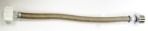

Hi, I am considering buying the Aquia III series for our new home and was wondering if any of the washlet seats fit this series?

Yes any "Elongated" Washlet seat will fit but you do need the "THU9090" adapter for it as the supply line supplied with the seat will not go up into the tank .

I just ordered the Toto Washlet E200 and already have the Toto Aquia III toilet, which btw is an amazing toilet, I have two of them. I see the comment about the THU9090 adapter required, so I ordered one. What about the actual mounting of the Washlet to the bowl? The Aquia III does not have exposed bolts underneath the seat and requires the self tightening type with the rubber contraption. Should I re-use the ones that came with my soft-close Toto seat? Or does the Toto Washlet come with hardware needed for attaching it to the Aquia III bowl?
Thanks, Chris
The new Washlet will have the seat attachement with it. Two toggle bolts, just like what came with your Aquia.
