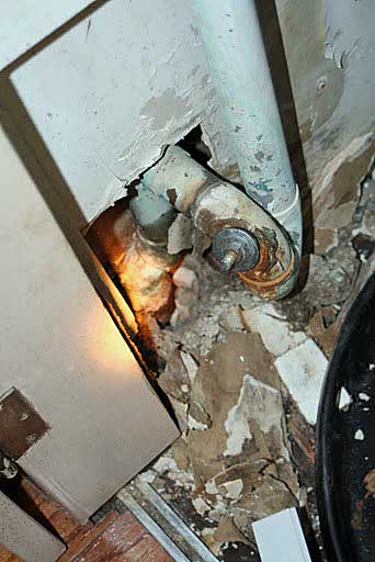

Hello,
This is a photo of my washer drain standpipe going into the slab.
Can you please describe what you see, in terms of how things are set up.
Thanks.
A little hard to see above. The yellow line below shows the edge of what's going into the slab.

What are we supposed to see? Is there a trap? Is the pipe 2" or larger? Is there a vent? Back off a bit so we can see more of the drain.

The first pictures show the 1-1/2" standpipe going into the floor. I am wondering what the setup is into the drain.
Here is a picture further back, showing the standpipe itself.

If I am seeing this right, there isn't much right about this. First, it would appear that the standpipe comes down into a P trap which is OK, but then the pipe goes into the wall and elbows down. Since there is no vent between the trap and the elbow, this creates an illegal S trap. Next problem. New washers empty their water much faster than older ones. This has lead to a requirement that washer drains be 2" minimum. Usually this means a 2" standpipe, trap and then somewhere after that into a 3" or 4" main drain.

We do not see what the P trap is connecting to so it is strictly an assumption that it is an elbow, creating an S trap, rather than a tee which would be proper. I have to take your word for it being 1 1/2" because it LOOKS LIKE 2", but we have nothing to compare the size to. There seems to be a "dogleg" at the floor for some reason, but we also have NOTHING which would cause us to assume you have a 2" line which would be easily accessible.

Yes, I'm wondering how the pipe is connected to the drain at the floor. A plumber who was here said it looked like it might be running into a 2" drain, rather than a 1-1/2" drain -- I assume because it is slipping inside of something larger for some reason (looks like iron pipe to me). He said it's hard to see what's going on or why. He didn't seem to think it was normal.
I am hoping it's not a 1-1/2" drain below and that someone would recognize the connector piece and whether it could be fitting into a drain larger than 1-1/2". What it's purpose would be if not. I guess you're saying it's an elbow of some sort that could have 1-1/2" fittings at both ends?

I can't believe nobody had replaced that yet.
Someone busted a hole in the fitting, and used a kitchen sink deck cover on the hole.
Can you explain this more? Busted a hole in what fitting? Any idea about the drain size from what can be seen or was done?

They used one of these for a plug. Or at least something like this.

Looks to me that 1.5" copper is cemented into 2" cast iron.You would need to remove the copper,once that is done then have C.I. rodded out then rebuild using the proper connectors.Can you find a vent as it will be needed.

I see what you're talking about, Terry. Yes the blasted boiler plug that collects debris, pin rusts apart, and I can't get it back on tightly if I try to clean it out myself. With the first snaking, a hole was cut in the pipe for that.

CY, thanks. The plumber did say something about it looking cemented in; maybe a 2". Now I can see what you're all talking about. I chipped a little away to see the pipe rim size better. So, the pipe looks placed up against the pipe on the right side and the void on the left near the dime is filled. It does look more like 1/4" of fill, to me. Is there a 1-3/4" drain size? Hopefully it's filled around the standpipe perimeter more than I can see. Yellow lines show the rim edge of the iron drain pipe

By George, I measured with a piece of paper and the iron pipe interior does, in fact, measure at 2 inches. Whew. I can't believe after all these years, decades, that this is the first time anyone has pulled the darn material away to actually look at the drain pipe itself. So it looks like this will be able to be brought to code at 2 inches and be able to handle the two fixtures that drain into it.

The dishwasher is not properly drained either. The T/P can drain into the washer stand pipe. You really need to open the wall up so you can see what is going on. It is possible what I first thought was an elbow that created an S trap is actually a tee which connects a vent. If that is the case, this may not be as bad as it looks. Remove everything to the main drain and replace with properly sized pipe, P trap, and vent and you should be good to go. But, that DW drain has to be redone.

It's all exposed. Here is a shot of the whole kaboodle. There is no T. It will be done with a T during the redo.
