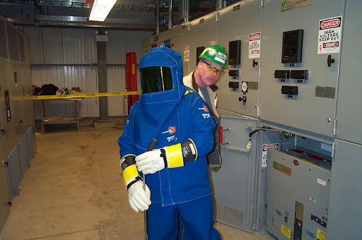

    There ya go! That should help pinpoint problems. Also you can *carefully* measure connections with a voltmeter. Of course if it is a good connection, you would not get any reading.
    So far as electrical PPE, how about this for safety...
    [​IMG]
