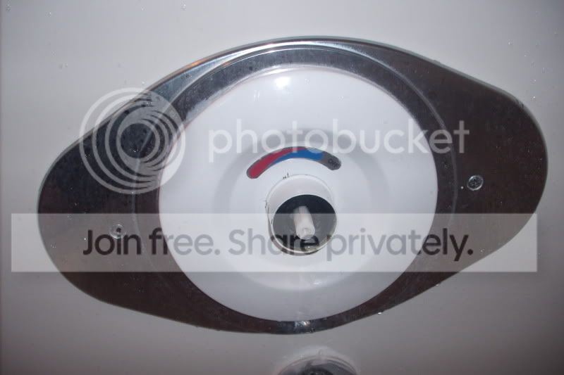

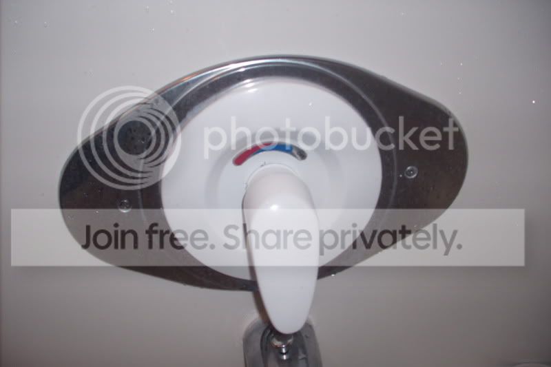

here's the best I could do for now:
If this does not help, please let me know.

faucet
May be PP, but their stem is usually black, not white. The instant, and very hot, water in the cold side is usually more a symptom of a cracked underfloor hot water line, than a bad faucet.

I'm guessing you are from the UK, in which case, I'm not familiar with that faucet.
If you have water shut-offs behind the shower wall, and if you have another bathroom to use, you can try pulling out that cartridge. You will need to turn off the water first and then remove the screws that hold on the backer plate.
Then remove the white sleeve. There may also be a retaining nut or a clip that holds the cartridge in place. Once those are removed, you should be able to pull out that cartridge with a pliers and examine it. Check to see if any washers are loose or damaged. There may also be a scald-protector that is sticking or otherwise not working properly. If there is no scald-protector, you may want to have one installed.
