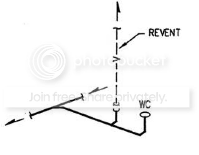

Here is a new drawing. I have very limited horizontal space to insert a vent for the toilet between the closet bend and the main. I do however have enough vertical space to insert a vent tee between the closet bend at the bottom of the trench and the top of the slab. This vent would run horizontal for about 18", but not flat horizontal, I can probably get 22 deg upward pitch to the exterior wall. Is there any reason that this will not work, or more specifically that it is against code? How else do you vent a toilet on a horizontal main if the branch pipe does not come directly under a wall?
Thanks again. The inspectors around here I have found are not that strict. I spend a lot of time making things above code and they usually don't even notice. I want to do things right regardless of who looks.
Scott

So it appears that there is and always will be some disagreements on horizontal venting. nhmaster, in your opinion it seems as though I am ok not to vent the toilet separately but others say that it is necessary. The toilet is 18" from a vent wet vent. Other than digging back under the footer and splitting off the main sooner I do not have room for a separate vent on the toilet. Like I said in a previous post I do have room in the horizontal piping to the toilet to install a tee and possibly even a wye with a very short (17") sloped horizontal vent to the wall. I cannot see how this would cause a problem. I am ready to start installing pipe but will not do so until I am convinced that I am doing it right.

If you are in Illinois the smallest pipe you are allowed to use under ground is 4" pipe. Water closet must have its own vent tied in after the closet bend rolled off the top with a 4"x2" wye then vented to the nearest wall.
Your best bet is to draw up your plans and take them to your local permit office and have the plumbing inspector approve them. I would also get a permit as well, if you get caught doing this work with out a permit the fines in Illinois are very hefty. Also double check with the inspector their are parts of Illinois that do not allow PVC under ground, and there are still parts that do not allow PVC to be used in drain systems that have metal pipes. I know they make fittings and such to transition from PVC to steal, CI, or even copper, but them are the rules in that town.

Nobody seems to want to answer my toilet vent question though. Can I vent out the side of the vertical rise to the toilet with a wye?

Always vented right after the vertical rise on the horizontal. And do not use a side inlet elbow. Should be 4x2 tee coming off at the upper portion of the pipe no lower than a 45 degree angle. I am still trying to find the best part in the code book that addresses your concern.

ok I found it. Each fixture needs to have its own vent. according to Section 890.1490 paragraph c
Section 890.1490 Installation of Vents for Fixture Traps
a) Hydraulic Gradient. Fixture drains shall be vented within the hydraulic gradient between the trap outlet and the junction with another drain. The hydraulic gradient as applied to a gravity drain and its vent connection is interpreted as the grade line. (See Appendix A: Table I, and Appendix K: Illustration R.)
b) Different Level. If any stack has fixtures entering at different levels, the fixtures other than the fixtures entering at the highest level shall be vented, except as otherwise provided. (See Section 890.1510.)
c) Horizontal Branch Drains. Where a water closet discharges into a branch drain, each fixture discharging into that branch drain shall be individually vented; however, this does not include battery or circuit venting.
