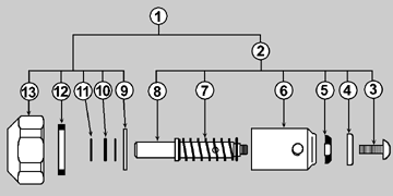

    Thanks Mario. Here's the exploded view of the cartridge in the old type Penal-Trol valves I'm working with. There are no Airtrol valves in the jail at this time. The problem I'm having is coming up with the faucet washers (item #5). I'm hoping I can buy the 39 cent washers rather than the $60-$95 cartridges... I'd sure be able to keep this customer if I could come up with this one...
    [​IMG]
    These washers have a larger than normal hole in the center, they're green, and made of nylon. The outer rim has two levels. It fits down into a cup type brass washer and the upper part of the nylon washer is bigger in diameter than the lower half.... hope this makes sense.

    Yeah, that is different than what I was describing.
    But with that exploded view you should be able to order the parts easily through an authorized distributor.
    One place you can get these parts is called "Industrial Mechanical Supply".
    They had your same drawing on the web.
    You can call them Monday through Friday 8:00 a.m. to 5:00 p.m. at: 1-877-258-2572.
    The item # 5 faucet washer is called a #33010520 gasket disk.
    You'll probably also need item #10, #33010400 o-ring, and the item #12, #33010495 bonnet gasket as well while you're at it.
