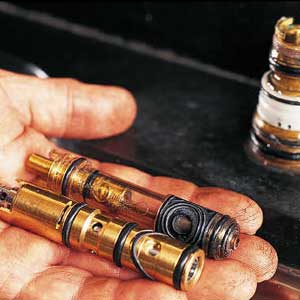

    We've FINALLY gotten the guts of our Moen cartridge (shower) out, but the rubber that surrounds it is still entirely stuck inside and we can't remove it. Please let me know if you have any suggestions; we've been trying for hours.

    You need to find or make a tool that can reach in and grab the rubber out.
    Long nose pliers... A hook of some sort...
    Did you get the whole cartridge out or, did the center stem only pull out?
    This is a picture of 2 whole cartridges below...
    [​IMG]

    We need a picture, because you are describing a problem with a brass core that you pulled the center out of it. if so you need a Moen core puller, but not the one Moen sells, nor the Pasco one since it will never come out if you cannot pull the piece using it. I have several different pullers besides those two and sometimes it takes more than one to do the task.
