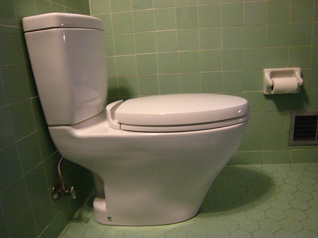

  13. Terry
    Joined:
    Aug 17, 2004
    Occupation:
    Location:
    [​IMG]
    Original CST414M installed with the old style SS114 Seat. This installation must be about ten years old now.
    While I was installing a new tub downstairs, the homeowner commented how much she loved this Aquia. Thinking she may want to take it with her if she moves.
