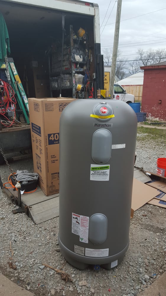

Master Plumber Mark
5,538
357
83
www.weilhammerplumbing.com
I am installing a RHEEM 105 gallon MARATHON electric water heater next week....
Installed cost about $2400
It comes with a LIFETIME WARRANTY on the tank
The unit sits about 30 inches round and about 5 1/2 foot high
You ought to consider this over all the other options...
I am pretty sure it will fill up your whirlpool tub
and you will have hot water and bubbles shootin up your ass just fine...
depending on how you adjust the jets...
This one is a 75 gallon unit

Lol - my bath is a much more zen like experience, but I will look into that water heater. I get the feeling it's time to go and have a face to face chat with a supplier.
