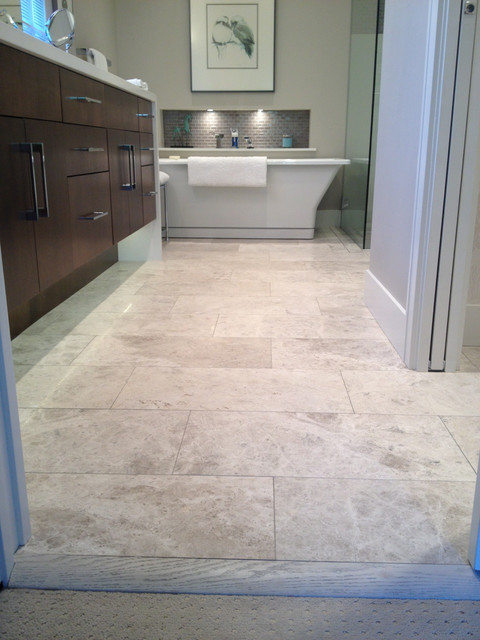

Last summer a client of mine took it upon himself to mill up a nice transition. He used oak and then a pickling stain I believe or some kind of white wash. Often we raise these floors when building barrier free showers.

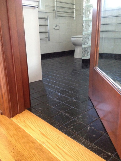

This is my best transition to date. I made it out of the flooring scraps . Not really a carpet to tile transition but you get the idea.

Nice work but my concern with that one is the trip hazard. For that reason, I would want the transition to contrast a little more to catch the eye rather than catch the foot.
With tile to carpet, there's at least one company than makes ramps designed to be installed underneath the carpeting to ease the transition. You could make them yourself, but to be 'seamless' it should have a slope in the order of 1:10...so, it depends on how much height difference you have to accommodate, and a moderately long ramp is harder to make. Cedar shingles under the carpet, done right, and you may never notice the ramp at all, but the commercially available ones are longer.

Tapered Oak Transition from Tile to Carpet. Stained with a Pickling Wash to give a faded white washed look.
