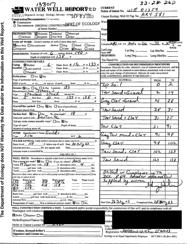

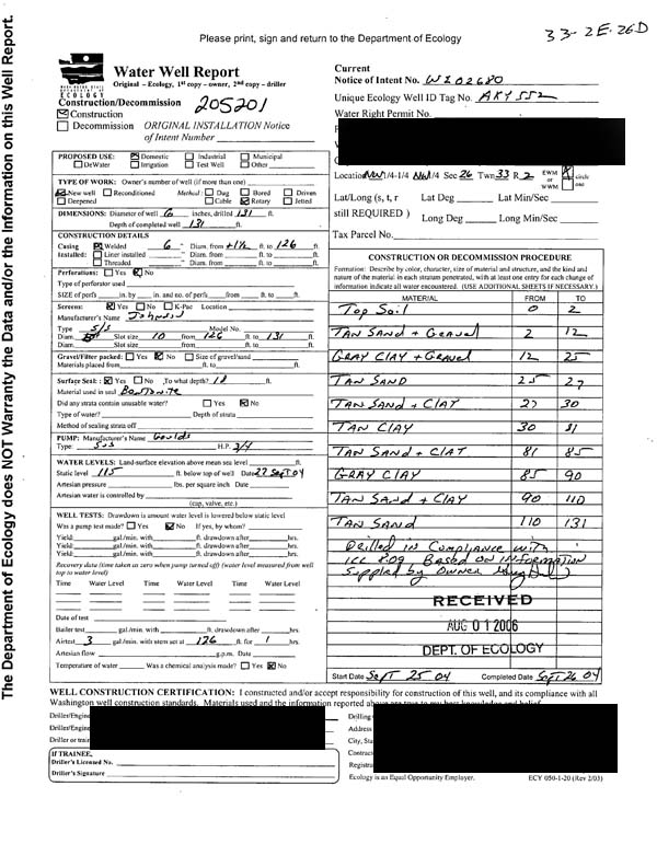

I figured I would update this post and get anyone's thoughts on the subject.
Before replacing the 3/4hp control box with a 2hp control box for the 2hp pump, I tested the starting and runnng resistance.
They were 12.1 and 3.6 roughly which is what the AIM Manuel said were for a 3/4 hp pump. SO this was surprising.
The well information that came with the house said it was a 2hp pump.
I went to the dept. of Ecology website and looked up well information in my area and found paperwork for my well and my neighbor's well, both were dug by the same guy.
My well had a 3/4 pump and my neighbors had a 2 hp pump. My well had an air test done (3 gpm/ 126 feet/ 1 hour).
I have no idea why I was given my neighbors paperwork.
I decided to recheck the well, pipes, pressure tank thoroughly and found that the 1 1/4 pipe connection at the well was barely even connected.
I literally pulled the threaded out without twisting it. This would explain all the bubble sounds I heard when the pump kicked in.
It would explain the difficulty it had with developing enough pressure.
The I went to the pressure tank and discovered it was waterlogged.
I was able to get it out of the pump house and unscrew the air intake valve and drain it.
I then pulled the bladder out of the bottom to see if
had an obvious tear. I haven't found one yet.
The bladder was covered both inside and outside by lots or rust and black goo.
I have no idea what the black stuff is. Pulling a bladder was like delivering a calf or something (lol) very slimey.
SO I
1- installed a check valve at the top of the well
2- Ran 300 feet of 1 inch pipe up to the pump house
3- Replaced the 85 Gallon pressure tank with one that is 50 gallons
4- Installed a ball valve on th eoutgoing side of the tank to experiment with water flow.
5- Installed a pressure valve that cuts out at low pressure
I turned it on and was amazed at how quite everything was.
I filled 20 5 gallon water jugs up before it lost pressure and went below 28psi.
I closed the ball valve quite a bit which lowered my pressure at the hose but th epump seemed to be able to keep up
with as much watering as I wanted the rest of the day.
If anyone has any suggestions or ideas I would love to hear them...especially concerning drawdow and flow as it seems I have a low producing well.
Here are the two well reports. The first one is the paperwork that actually goes to my well.
The second one is the paperwork I was given when I bought the property.

Thanks for the feedback. Your well is a low producer and might not be enough for some lenders. Your neighbors report would look a lot better to a buyer, so you might have had an accidental on purpose agents mistake. Be glad you got the 3/4 hp pump, otherwise that well would be sucked dry quick.
Sounds like you are good to go - good detective work. Others here might object to the checkvalve at the well head, but I use them too.

Well "accidental on purpose" would totally be par for the course considering all the other things that took place from the realtor..but that is another story.
