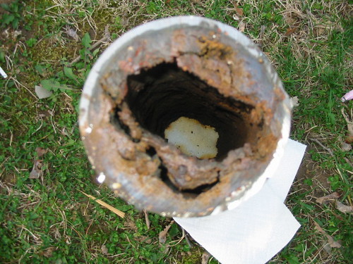

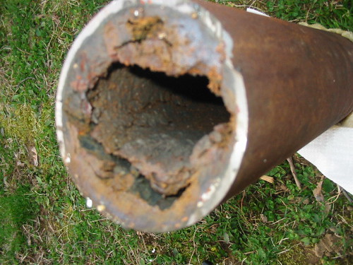

In the course of a bathroom remodel the plumber cut the soil stack to allow the addition of two new drain lines. In the section that was removed it is easy to see that the accumulated build up on the inside of the stack has reduced the capacity by half or more. Right now there are no blockages but it seems that we're headed in that direction. The house is about 60+ yrs old.
Should anything be done now to prevent problems in the future. I'm a little worried that agressive action will create a blockage. Is there some way to do regular treatments to slowly eliminate the buildup?

If it is a cast iron pipe, then the accumulation is rust and nothing is going to remove it. But it seldom creates problems in a vertical line, unless it causes stress and the pipe cracks.
mike08054
It is a black paste substance and it is soft. I'll take a closer look tonight and see if I can also take a picture.
mike08054
It's definitely organic (waste) not rust or lime.

looks like it would be best to either grind through it
with a large sewer calbe and lots of flushing of water
or change out that funkey pipe...

rheem it out first
Spend the money for a drain clenaing
the only cure is probably a good rheeming out
with a good sharp cutter....by someone who knows how
to cut through tree roots...that does this all the time
it is his job to flush the line and remove all the funk for you .....

After he has rheemed out the pipe
you can try something like a few gallons
of muratic acid being poured down in the toilet
full strength over a few hours every year or two to
sort of break up any new growth.....
ask a local drain cleaning guy his advice.
its not a fun job either way you shake it.

I would either jet or use a 4 bladed cutter to clean the line. This is the before and after pic of a urinal line. That's what 50 years of old man piss looks like.
