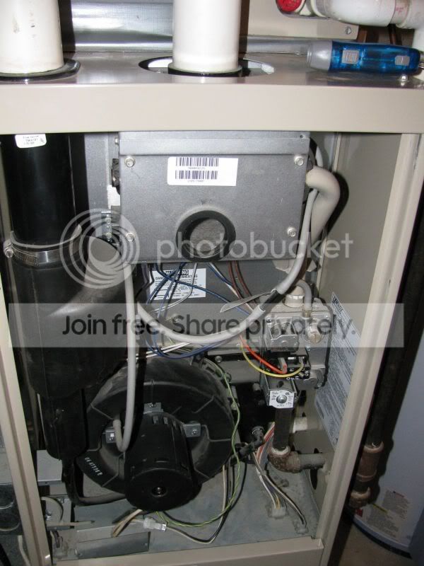

I had the cover off of the furnace today and thought I caught a whiff of natural gas...not overpowering and only detectable if I stuck my face right up at a certain place in the furnace..it is not spread to the cellar and doesnt seem to be growing
Take a look at this pic

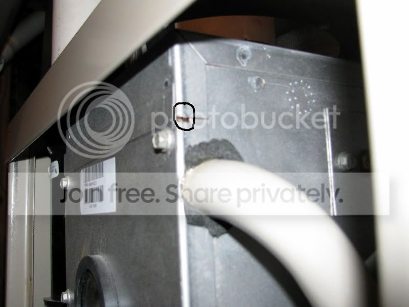

The smell is coming from the upper right hand corner of the silver box the best I can tell...right to that the right of that top bolt on right...at the very corner(s) of each side of the box next to top bolts there is a small opening into the box...they look like they were built that way
You know maybe it has always been like this and I am just noticing because I have been super wary of smells lately......

The smell seems to be coming from this opening but this opening has always been here..it looks like it is supposed to be there

It might just be a loose connection somewhere on the gas lines or even on the pilot tube (if you have one). The smell of gas often drifts from where it originates.

This is a tricky one. You could try and call a pro, and have him tighten the connections up. Or just leave it. The risk is that the pro comes out, tinkers and you can still smell the gas.
Have him tighten the connections on the water heater too. Remember what I said about the smell of gas drifting.
Actually, I remember you said you just had a WH installed and had other odor issues with that. Is that correct? If so, I bet it is the connection to that.

What is weird is those holes have always been there..if you look it looks like they are there by design??
