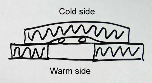

Your shower lines in the attic is a bad idea as described. Those lines need to be in a special insulation box (made from thick foam insulation) sealed to the ceiling.

For the in-attic piping, I do recall reading a response from Terry to another thread that said something to the effect of surrounding the pipe with insulation, but leaving it uninsulated underneath to allow better heat transfer from the room below. There would be some open space around the pipe where trapped heat from the room below can build up. Also, I would pitch the pipe slightly to help water drainage. Maybe use PEX?

This was a photo Terry linked us too. It's close to the way I do it. But my way's better! LOL

I build the ceiling water line boxes out of this stuff.
ISO Board.
Water lines about 1 3/4" off of the back side of the ceiling drywall. The Iso board sealed to the homes vapour barrier and keep 1" away from the pipes.
Like this but upside down.

Thanks for the pictures - that looks like a nice solution. I would just be going up the inside wall, then over the shower drywall ceiling - in that setup would I just seal the board to the drywall in the attic?

In Seatlle I'm sure you have a vapour barrier requirement for the ceiling. I would run a bead of spray foam along the vapour barrier. Drop on a piece of foam. Repeat for the other side. Run a bead along these two foam pieces. Add the top. Then stick something with some weight onto. Maybe some 2"x10" 's off cuts to weight the foam from expanding too much. Once you have this in place then lap over top again with the loose batt insulation.
This foam ISO stops any air flow from hitting the pipes. The ISO foam acts like a beer cooler catching the heat from the bathroom escaping to keep the pipes warm.
In Vancouver this is a code required step.

When you become a plumber and have to go out when the entire city is out of power repairing freeze breaks, get back to me.
I've been fixing frozen pipes in the Northwest for forty years. :)

So, I think I get the idea of the picture, but not the details I'd probably run into trying to do this.
Do I just run the pipe directly above the drywall and through a block for support. Then place rolled insulation on both sides of it (not underneath) and also over the top?
Or is the picture showing the pipes laid directly on the drywall with the insulation over the pipes, kind of "doming" it a bit?

I have only fixed one busted pipe line ever in my career caused by freezing. I do know that the inspectors in Vancouver would never let that fly. They like the ISO boxes.
29,946
3,460
I've never had to fix a broken pipe doing it my way.
And my way is approved by the inspectors.
Anytime you put a blanket of insulation over the pipe, it works. Foam insulation in an unheated space does not work.
But anytme you keep the pipes on the warm side of insulation, either by batts, or by making a foam box, it works.
Code allows wrappng a pipe in foam, which left in unheated spaces can freeze rather quckly. I never have had to go back on my repairs.
