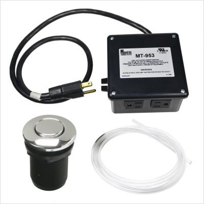

If it is a regular wall switch then it should be GFCI protected. Don't most disposers have an air coupled push button?
I agree with jwelectric. I've never seen a GFI on a disposer.
And I sold very few air switches for disposers. They are handy if there is no space on the wall for a switch though.

I would choose not to use a GFCI but then I would use an air switch.​
