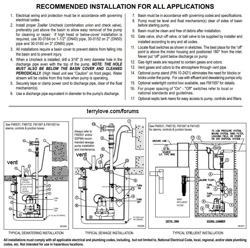

I'm planning to finish my basement but I've run into a problem. I originally thought the builder stubbed out two pipes that vented out to the roof: one for the bathroom fixtures, and one next to the ejector pit. Upon further inspection, I found the vent pipe next to the ejector pit actually runs along the joist and ties into the bathroom vent pipe. Which means I only have one 2 inch pipe vented to the roof. I wasn't sure if code called for a dedicated vent line for the sewage ejector. If so, I seem to be short one vent line. So my questions are:
1. Can I use the one vent line to tie into the bathroom fixtures (WC, lav, tub) and the sewage ejector?
2. If not, what would be the best solution? Using the vent line for the ejector and AAVs for the fixtures?
Any suggestions would be appreciated.

Most sewage basins require a dedicated 2" vent. The vent does not have to go up directly above the basin. Running a new vent through the inside of an existing wall up through the attic and roof is fairly easy in many homes. If running inside the wall does not work, it can be ran it up through the back corner of a closet or pantry, where it can be boxed it in with some simple framing and drywall if need be.

If the house has a 3" building drain, it should have a 3" vent or multiple vents which when added up equal the area of a 3" vent.
There is little to say that venting through the existing vent through roof might not work, but it would not meet code and thus not pass an inspection. The code and inspection process exists to ensure that the installation will work properly and in a safe manner.
There are very few places where I find using an AAV is the way to go. When an AAV is used it must be installed in a location that will prevent it from ever becoming contaminated with a backup; where any sewer gas leak will be immediately detected, and in a position that will allow it to be easily and immediately replaced. I would much rather put in a proper vent and never have to worry about it again.

I have NEVER installed a "vent through the roof" for an ejector pump system. Connecting to the existing vent is perfectly adequate, although it might not be "propeer" in some areas. The only reason for a dedicated vent is to minimize sewer gas odors when the pit's cover loses its seal. For that reason, your "vent for the pit and AAVs for the fixtures" would be a senseless solution.

I would have to make a long horizontal run. Then I can use the existing 2 inch vent pipe as a dedicated line for the ejector. Is there any code I should be aware of for adding the new vent pipe?
The issue you would probably run into with this is that the vent must be run at 2% or more grade to drain back to the fixture drains. The vent can also have no "jogs" that would create a trap for moisture/condensation in the pipe. It must be able to flow just like a drain.
If you were going to connect the pit to the existing venting system, the connection would need to be made above the flood rim of the highest connected fixtures, so in many houses it would very likely be just as easy to run a new vent.

I missed the line where he said that the was an unused 2" vent in the basement. So if the listing and labeling on the basin calls for a dedicated 2" vent, HJ would just ignore it?
